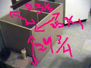

this is the box
was for two 15 but now is for a single 18 inch sx im going to remove the middle part

yes thats me the area is 9.5 cbft and i want a port maybe im going to built a interchangable port i think you show me some pics man that really help and thanks a lot bro im going to do the way you said the sub firing up and the port in the back side

w/ a box that big...make sure you brace it.
also...double the baffle.

thanks alot man im going to tune it around 32 hz i think im going to do around 110 sq inches of port and you think polly fill is need it or dynamat i already have polyfill so i think im going with that but wat you think

dont use polyfil or dynamat in a ported box.
SPD,
you have since the port opening is 3"x 14.5"...you have 43.5sq inches of port. what is prolly enough for up to a 4.25cuft (net) box.
