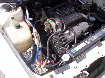

Gold Member Username: B101Queen City, NC USA Post Number: 1556 Registered: Sep-05 | aiight, been too bored yesterday, I stipped the entire car.. and Im doing my entire electrical over.. this is what happened so far... I have 2 runs of 0ga wire going to the back dist blk!! each fused with 200a anl fuses, under the hood. I have big3 0ga wire and 4ga wire.. I now have 2 0ga wires coming from my alternator to battery!!! << This made a HUGE diffrence, let me repeat HUGE!!!! damnit HUGE diffrence! now with the car runing, lights on, and ac blower high.... instead of voltage droping, it raises higher!!! <<so so sweet... I measured 14.6v with car runing, 12.8 off. And that test was done with 1 battery under the hood right now! I will be adding a yellow in the back. Also to the back will be a total of, 5800RMS not total watts in the trunk!! If u have a HO alternator, I now suggest that people run 2 runs of 0ga from HOALT-to-BATT! |

Gold Member Username: B101Queen City, NC USA Post Number: 1566 Registered: Sep-05 | fresh pictures, just got back up stairs... |

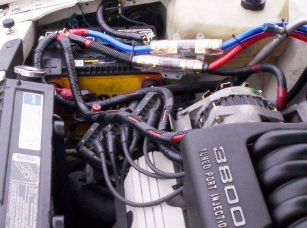

Gold Member Username: B101Queen City, NC USA Post Number: 1567 Registered: Sep-05 | POSTIVE blocks... connects both 0gauges... still got to buy a neg dist block now.. |
Gold Member Username: TheelfkeeperStockbridge, GA USA Post Number: 1248 Registered: Feb-05 | poor little battery post, lol. i think the extra strand of wire helped you because your not using a nice battery terminal which has more surface area for current to flow from post to wire. its trying to squeeze itself through thoes ring terminals. could be wrong, just a thought. i've just got 1 strand of 1/0 and the stock wire, i sit at 14.4-14.8 at idle and 15.5-15.8 at higher rpms. and with 2 JL 500/1's and a JL 300/1 at full volume, and everything in the car on, voltage drops about .2 volts. |
Gold Member Username: B101Queen City, NC USA Post Number: 1569 Registered: Sep-05 | lol the terminal rings are big and long, im sorry they look so small, cause there is like 4 strands of 0ga on 1 of them.... this is just my starting batt of 1000CCA.. but my system is not going to be using that, it will have about 2 Yellows in the back... or aNSB 125! Im just getting the current to the back... ... and in return I will protect my investments... also this is very very neccasry for 5800RMS! not 1000... in addition my car factory electronics suck alot of power by themselves.. every single feature is digital! comes with standard 105 or higher. which the car electronics treated like a 60a alternator! |

Platinum Member Username: GlasswolfWisteria, Lane USA Post Number: 11353 Registered: Dec-03 | 1/0AWG is able to handle up to 350A of current. Really no reason for two parallel runs of 1/0AWG with a stock alternator. a 200A alternator should be fine with a single 1/0AWG line in fact, since the distance would only be about 10 feet total. |
Gold Member Username: B101Queen City, NC USA Post Number: 1570 Registered: Sep-05 | i love these engines, thats why they on the list of top 10 engines... ^^ dont even get me started about gas mileage... I treat my car like a Accord..... the volts were allways up for me since I got my HO alternator.... but I noticed instead of them droping like .5volts under extremlty heavy load; they went up .5-1volts... some morning my voltage is right under the redline, so about 16v strong... the lowest it will sit somedays is like dead on 13.4-14 volts... People when I said it went up, I meant it went up @ IDLE!!!! UNDER 800rpm...... Now thats current flow for that a$s..... all test were done at idle... hehehe maybe thats why Brandon misunderstood... umm Glasswolf, I know how much it passes by the books, but Im kinda of reality/implementation guy.... They dont pass that much current when they are tested.. trust me... and 2 strains isnt much at all, try people who run like 20strains to the back of a ASTRO van... Glasswolf if had a TL meter right now, Ill prove u, u can gain with extra strains of wire. Now at a certain amount, it just dont matter... |

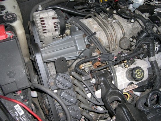

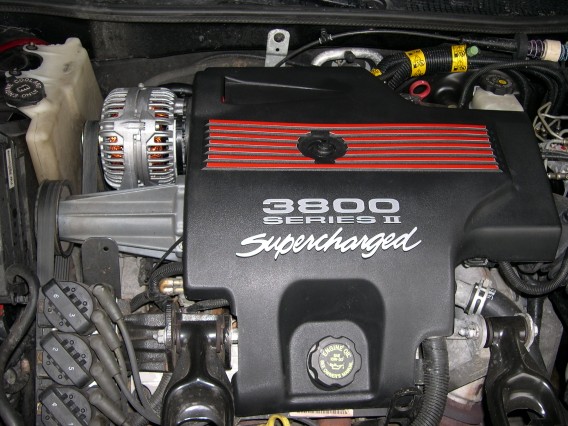

Silver Member Username: Safe_crackerChicago, IL US Post Number: 363 Registered: Jan-06 | Hey B that is almost my engine, I have the series II supercharged, I was having such a problem unitil recently trying to find a bracket for my alt. I have a weird setup that has a support bar on top that holds it and some weird support underneith. Iraggi says they have done several like mine and sent me the appropriate bracket for it. I ordered the 300A amputator series which is in a large casing think it looks like your. Can you take some close ups so I can get a good idea and is that a 6 rib serpentine belt? thanks...Polo.. ;) |
Silver Member Username: Safe_crackerChicago, IL US Post Number: 364 Registered: Jan-06 | It seems where you alt is I have a SC, lol. I am hoping Iraggi guys know what they are talkng about, they see too. See the stains on my engine, that is from a battery exploding, note the rust also, car has only 51K on it (Pontiac GTP). Polo.. |

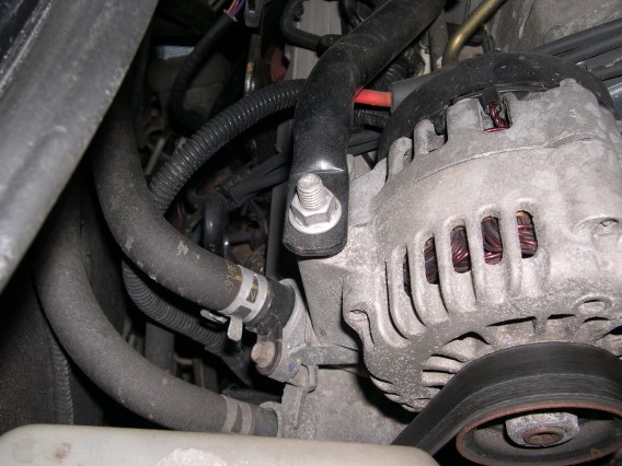

Bronze Member Username: BassheadjoshUtica, MI US Post Number: 17 Registered: Feb-06 | Ok so I have a question...how do I get the extra positive wire to go on the alternator? I've never changed one before, but from the looks of it there is no way to attatch anything extra...help a newb out lol. |
Gold Member Username: B101Queen City, NC USA Post Number: 1582 Registered: Sep-05 | Polo, yeah, they are the same engines... I love the SC versions to these babies... they really move... series 1 came SC also, but the diffrence with series 2 is the accesories placement.... yea the belts are the exact same, except u have 1 extra belt to spin the SC.... where you alt is / my power steering pump is... the black bracket for your alternator, connects to my steering pump.. but yea, looks my alternator suposed to be where your SC is... heheh Ill have to find my closeup pics, or take some more today... I needed to prove to Nathan I had enough space in there (large case)... I still had a little space to spare after that... but series 1 has tons of space I must say... "i'll have to agree w/ you that running more wire is better for SPL installs. ---in competition...there is no such thing as overkill--- " ^^^^^^^^^^^^^^ Exactly; no such this as overkill!! Man I had my 2500d in the car yesterday..... LORD!!! ^^^^ shows exactly how killer this charging system is.... that battery meter on dash didnt even move!! with only 1 battery currently in the car!! JEEEZ! system up, lights, blower highest..... .... OH thats at IDLE too.... under 800rpm! |

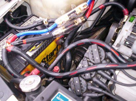

Gold Member Username: B101Queen City, NC USA Post Number: 1583 Registered: Sep-05 | Ohh more cleaning up went on yesterday... This is how everything sits now.... |

Gold Member Username: B101Queen City, NC USA Post Number: 2101 Registered: Sep-05 | power is real nice now lets trade engines, it will fit snuggly I also see I have to clean up some more.. ![]() |
