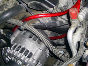

I just put the "big 3" in my car, and my cap used to run at 14.8, now it runs at 15.1, would that overload my battery? Upload
Yeah, cars a little dirty, but i live on a rock road, Hard to keep everything clean :-(

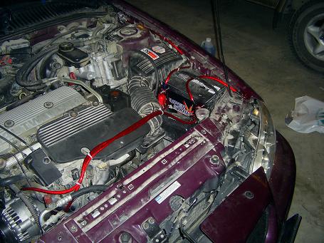

Ok, here is a diagram of upgrading your big 3.
John, this is a picture of how I have my setup done.
(Note - the dotted black line is optional, I personally run a dedicated ground wire back with my power wire)
Seth
Username: Fandim
Reno, Nevada United State...
Post Number: 787
Registered: Jun-05
This takes care of all big 3.
(they're numbered in the picture)
1. Alternator to battery
2. Battery neg to chassis.
3. Engine to chassis.
Also, you dont need the whole distribution block thing. That's just something I did to shorten the length of wire between my alternator, and my sound system. (Instead of running it to my battery, then doubling back from my battery to the back.) And it keeps things looking nicer w/ only one large wire going to my battery.
