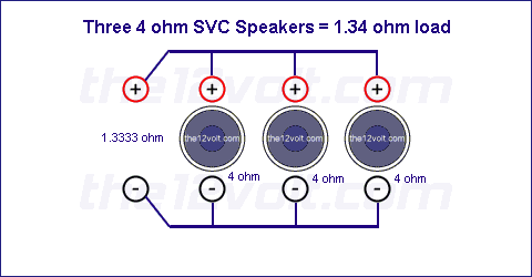

look @ this i'm not seeing a possible way 2 do it cause ur subs r normally connected this way
even if there is a way 2 hook it up - ur amp will be severly underpowering those subs which require 1200wrms combined 2 run well (though they can handle more wrms)
i'd say buy a good MONO amp that can do around 1500wrms @ 1ohm ...
