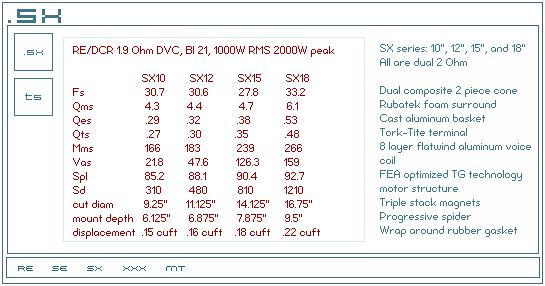

Bronze Member Username: AkacPost Number: 26 Registered: Jan-06 | ok ive been thinking about this all day. could i fit two 15" sx's in a custom fiberglass box. could that work? how much cubic feet would those boxes have to be. here are the specs from re's webpage.![]() |
