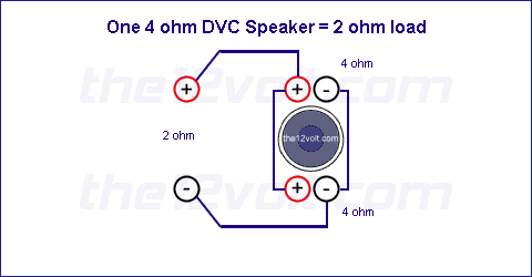

Unregistered guest | can you wire two dual vioce coil 4 ohm sups to a single speaker wire terminal on a d class amplifier as demonstrated at the following web site http://www.crutchfieldadvisor.com/learningcenter/car/subwoofers_wiring.html?subs =2&impedance=DVC4x2 thanks just want to make sure i have it right before i buy everything looking at this amp http://www.sonicelectronix.com/viewitem.php?id=6191# |
Gold Member Username: B101Queen City, NC USA Post Number: 1356 Registered: Sep-05 | everything looks A-OK with me! |
Unregistered guest | do you splice everything togther into a positive a negative terminal cause the amp has only the one terminal or do the sell three way connectors you can buy thanks for the help |
Gold Member Username: RovinTrinidad & T... Post Number: 5771 Registered: Jul-05 | not sure what u r asking but if u got 2) 4ohms dvc subs to be attached 2 a MONO amp u connect each sub like this to each terminal on the amp ........ |
Gold Member Username: B101Queen City, NC USA Post Number: 1359 Registered: Sep-05 | u want to wire them exactly like above to a 1 ohm load! the wires can be split, or simply twisted together at the amplifier! |
Gold Member Username: B101Queen City, NC USA Post Number: 1360 Registered: Sep-05 | Rovin, I think he was refering to the hperlink he had for 2 dual4s wired to 1ohm load, for his 1ohm amp. |
Gold Member Username: RovinTrinidad & T... Post Number: 5773 Registered: Jul-05 | B - I thought u were joining us this morning !? ....... |
New member Username: Chazer__DenverUs Post Number: 8 Registered: Feb-06 | thanks the amp that i was looking at only had a single poistve and negative terminal on it for speaker wires so i was wondering if you put the positve and negative wires from both subs into the single terminal on the amp sorry it was confusing |
