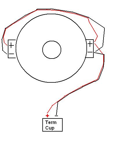

just built the new box and i have to wire the subs to the amp now. They are re se's dual 4 ohm subs. I have a dual 12" sealed box with 2 separate chambers. I was wondering how to wire the subs up from the amp. Do i use a terminal cump for each side then for example with the positive wire do i wire it to each positive spot on the terminal cup then on the inside do i wire it to the positve spot on the vc? it seems to me doing it this way has alot of different places where something could go wrong. Is this the only way? or is ther something else i can do. I was only figuring on using one cup and wiriing hte subs that way but its a big mess. any ideas or places to see how to do this are appreciated.

I'd do this on each side -

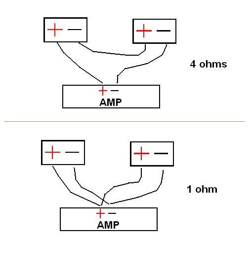

That would give you 2 ohms at each term cup - from there you could easily wire 4 ohms or 1 ohm at the amp.

thanks that really helps. Now when after i wire it like that how do i wire the two cups to the amp? and this may be a dumb question but can i use just regular speaker wire? or do i have to use special subwoofer wire. Regular speaker wire has a positive and a negative speakerline already built in to it, which you already know. but how do i use that to wire the sub? do i just take both wires and put it in the terminal? or do i rip the wire in half and use the positive and the negative separate?

so how do i wire the two terminal cups to the amp? would it be the same as having a dual 2 ohm voice coil sub on a mon amp?

yup, you got it.
