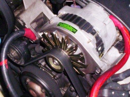

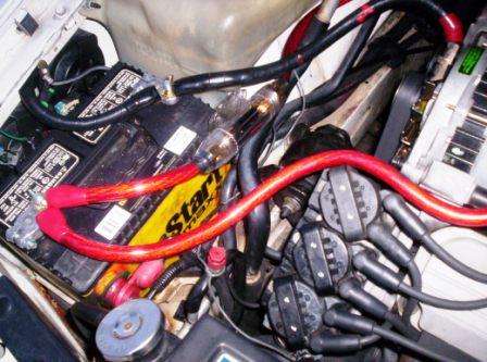

batt neg 2 alternator casing!!
my car has big 3 4ga & big 4 0ga!
Username: Fandim
Reno, Nevada United State...
Post Number: 746
Registered: Jun-05
I have one of those happy little green stickers on my alt too, lol.
