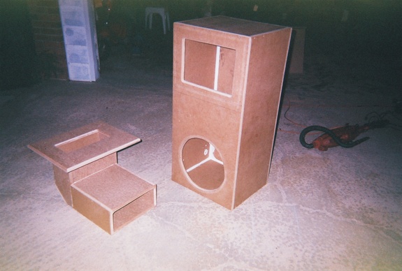

Never mind i answered my own question this is what i was talking about i found it on you page marshall.How come its not a fully shaped L?
Username: Jprix82
Post Number: 148
Username: Southernrebel
Monroe, Louisiana USA
Post Number: 2204
Registered: Mar-04
you talking about how its angles in the back?
i originally built the port in a true L-shape, but if wouldnt fit in the box. (lmao, dee-dee-dee)
so i just cut it and made it angled. it actually helps air flow cause it makes the port not have a 90degree turn.
