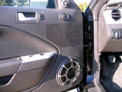

i went with morel elate 9- 3 ways used the 9" woofer as a sub in door works great the mids are in stock location Upload
Username: 54danny54
Betsy layne, Kentucky..GO... USA duh
Post Number: 1975
Registered: Nov-04
lol dayum how did u fit a 9 inch speak in a door
Username: Stavros
Post Number: 14
the depth of the morels are just over 2" for the 9"

Username: Stavros
Post Number: 17
you are right, but the out side dimension was 9" so that is what i went with, the mids and high's are right on brings my music alive i am not done with the 9" it give a lot of deep base the thing looks like it is going to jump thru cover,the morel people in Isreal told me to give these 250rms all day to the woofers so i did and bi-amped the mids a tweets 150rms so each side is getting clean 400rms i think i hurt myself the first time i cranked up,my ear was tinging for 2 days
don't ask about the 4 jl's i got a good deal enough saidUpload
