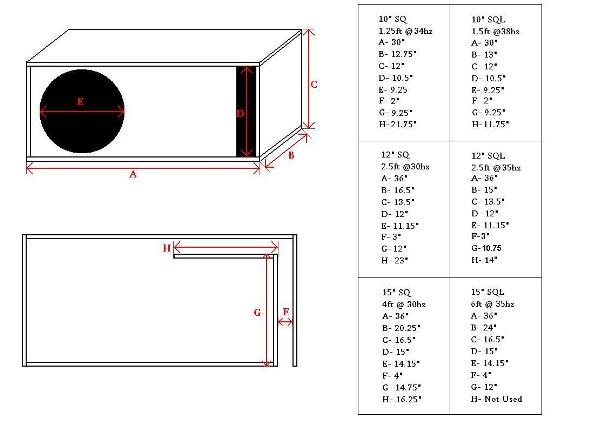

ok, Just want close to w7 type bass and sq. just learning how to make boxes so not sure on whats best. the demensions i found on this site were Upload
Can you help me modify this a lil for the best spl/sq combination

move H- to about 18-20 inches
move F- maybe add a 1/2 inch
move b- around 23 inches
im just going off the SX 12 box that i made soo im just throwing out what i would think it is. i agree with rovin "email Marshall White - he has 1 of those & has alot of experience with it ......."
he'll tell ya what to do

those boxes are a lot bigger than what they say if you do the math... I have good 3d plans for a box that's 4ft^3 tuned to 28hz if you want them. perfect for the SX 15".. if you want to increase the tuning freq, you can shorten the port length (this will add to the net volume as well, but it wont matter that much! I had mine in 4cubes and Marshall is running 6.5cubes I think...)

would the dimensions on that "15 sq" be good dimensions for a mtx9500?
