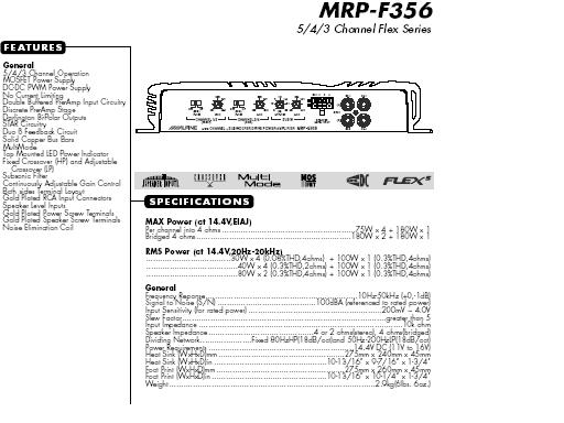

Ok, I think I just found the prob. It seems to be on the 5th channel (sub), which is somehow connected to the rear channels... As soon as I plugged both rear speakers (Proaudio 6"*9"), it started heating fast, cutting in and out the outputs. Then I removed one of them to get 4 ohms, started working hot but no cuts, with very weak bass (gain at max), even weaker than in the front ones, which in turn had the "HP FILTER" on at 80Hz. So, What seems to be happening is the sub/rear outputs are degraded and need fix, maybe due to water ingress I had a few years ago on the room the amp was stored (for 6 years, in the box)! Would you agree? See schemes. TIA Page 1Page2

may be a damaged amp.
