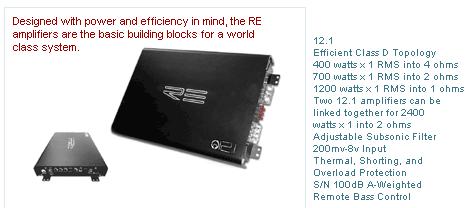

Silver Member Username: CenusHicksville, Ohio Usa Post Number: 678 Registered: Jan-05 | a dvc 2ohm sub means each voice coil is 2ohms so when wired in parrell it makes a 1ohm load and when wired in series it makes a 4ohm load. and 2 good amps to power that sub would be kicker kx1200.1 or RE 12.1 |

Silver Member Username: CenusHicksville, Ohio Usa Post Number: 680 Registered: Jan-05 | how much do u want to spend, the RE 12.1 sells for 390 shipped, which would make a perfect amp for that sub. |

New member Username: Kirbdog22New Bern, North Carolina USA Post Number: 9 Registered: Nov-05 | what is the RE 12.1? any others besides that? |

Silver Member Username: CenusHicksville, Ohio Usa Post Number: 682 Registered: Jan-05 | http://www.reaudio.com/html/amps.htm thats the RE 12.1, kx1200.1,sx1250.1, |

Gold Member Username: AraknidBOCA , FL U.S. Post Number: 1204 Registered: Nov-04 | puts out an extra 200 watts but should work nicely. |
Bronze Member Username: Kirbdog22New Bern, North Carolina USA Post Number: 15 Registered: Nov-05 | where could i get this amp online? price? |
Gold Member Username: AraknidBOCA , FL U.S. Post Number: 1206 Registered: Nov-04 | 390 shipped and directly from REaudio. |
