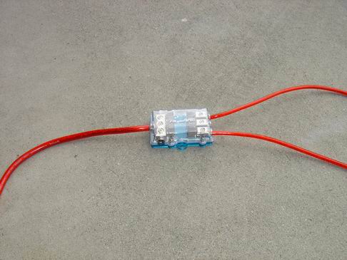

Silver Member Username: BestmankindLos Angeles, CA USA Post Number: 208 Registered: Oct-05 | john-heres a pic of the fuse distribution block ![]() Rovin- ![]() |

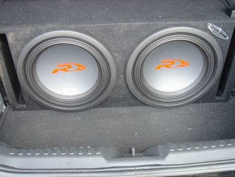

Gold Member Username: RovinTrinidad & T... Post Number: 2140 Registered: Jul-05 | EVIDENCE ! - lol Imagine how shweeet it will all be in a better looking & properly speced box ! ...... ![]() |
Silver Member Username: BestmankindLos Angeles, CA USA Post Number: 211 Registered: Oct-05 | yeah, i paid only $40 for this box. gotta build my own. |
Gold Member Username: RovinTrinidad & T... Post Number: 2142 Registered: Jul-05 | I'm gonna build mine with 1" though when i get my subs . I find that 3/4 still tends to reasonate & thats extra work to do internal bracing using 3/4 ........ |
Silver Member Username: BestmankindLos Angeles, CA USA Post Number: 214 Registered: Oct-05 | i don't even know what that box is tuned to. i had a box tuned to 30hz in my car when i made a single enclosure for my audiobahn right before these. the box tuned to 30hz sounds pretty good in my car. with these i am thinking maybe 32-34hz. |
