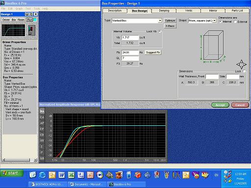

Here is your graph, and specs:
Fs= 25.18hz
Qms= 8.8040
Qes= 0.3579
Qts= 0.3439
Vas= 67.30 Liters
Sd= 0.034636 Sq. Mtrs.
Re= 6.93 Ohms (DCR)
The following boxes do not include driver displacement. Please add for driver displacement otherwise it will alter the FO etc.......
Sealed = Red
VB=15.61 Liters / .551 cubic foot
F3=58.12 Hz
No stuffing
Ported = Yellow
VB=32.15 Liters / 1.135 cubic foot
FB=27.66 Hz
F3=34.12 Hz
DV=2"
LV=8.141
Install 5/8" to ¾" thick carpet padding on just the top and back walls. Do not do all of them.
X-bass = Blue
VB=48.63 Liters / 1.717 cubic foot
FB=24.81 Hz
F3=29.29 Hz
DV=2"
LV=6.33"
From the graphs it seems that the ported will be the most effective. It stays at par almost at the roll-off. The X-bass starts to decline slowly above 100 Hz , but it extends 5 Hz lower. It's up to you. Just my $.02.

Thanks alot Mix, they're definetly going ported. I ran a graph using Win ISD and got similar results but not as thorough as your program (boxes came out to 1.4 cubic feet with 13.3in 3in ports). I really appreciate the work you put in for me.

I havent used the formulas for a few years now ever since the software programs came out with the infinite slide rule. I use the BassBox Pro6 to calculate it for me. I just input the port diameter and it gives me the port length. If I go too wide it tells me in red that the box is too small for the port size. I usually just try to get the widest diameter port without going over. If you have too narrow or short port, then you get port noise. It sounds kinda like extra air.
If you want to subtract/add port displacement for it, I wouldnt even bother because on a PVC port all you have to subtract/add is the walls of the port, not the entire port.

I am guessing that you are asking how long would a 3" port be for the 32.15 liter ported box that BassBox Pro6 has designed for your sub.
If so, then the program says 19.82", BUT it is highlighted in red (saying that the port is too big for the box.
If you are reffering to your WIN ISD 1.4 cubic foot ported enclosure then BassBox Pro6 says 17.65"
Both of these calculations are using 3" ports

The 1.135 cubic foot box originally came with a 2" X 8.141" port.
You then asked for a 3" port. So the length changed to 19.82".
The program highlighed the 19.82" port in red, meaning that it would be too long for the size of the box.
So like I said before in another thread, " I usually try to get the biggest diameter port without going over" So I usually back it off one size below the red highlighted one. This is to overcome port noise.

According to BassBox Pro the 2" port is the largest port that would fit inside the box volume.
The 3" port would be too long. Thats why it was highlighted in red.
The wider the port diameter, the longer the port length has to be, compared to a smaller diameter port.
