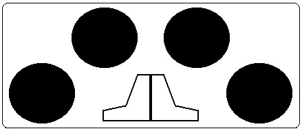

i want to put 4 8" speakers in my trunk all in one box and the thing is is that the box's out side measurements can only be up to 35"L and 12.5"H the depth dont matter now the picture showed is an idea of how i want it to look but it is not to scall the speakers well be closer together and the top 2 well be a little bit lower but i want the simble there for what ever size it has to be i want it there
four 8's with jl simble
Now my question is is it realy neccasary that i have indavidual chambers for each speaker because that is a lot to build and to cram it so close

nope no need.
they can share the airspace as long as all four drivers are wired up and working together.
if one fails, that's when you'd have problems.
that's all
one chamber is fine
you could also do a false floor and have all 4 firing upward..

personally, I'd divide the box.. but yeah you can still get away with a single chamber if ya want it lighter.
remember, that divider will reinforce the box, too.. making it stiffer.
that's a good thing.

ya i could give each there own air space but thats alot of work so i am just going to divide the box in half
now speaking of air space would i take the air space for one driver and times it by 2 for a box that has 2 of the same drivers in it or is there another and better way to calculate the air space

yup just double it
and half is good. that way each amp has its own pair of subs separated.. if one amp shuts off it won't affect the subs on the other amp in their own space.
also the divider will brace the box internally.
