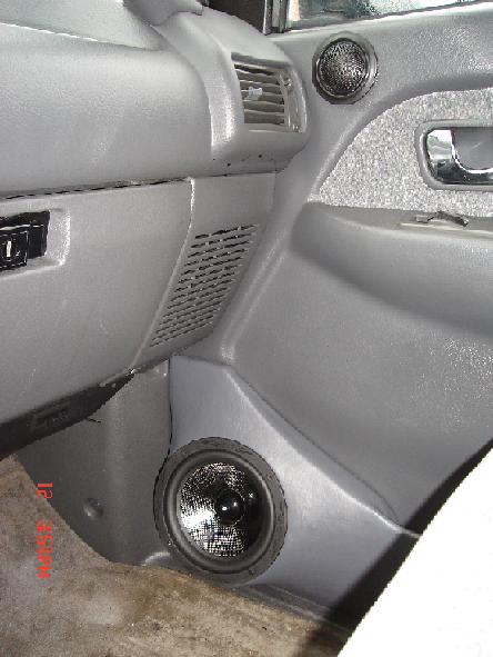

Gold Member Username: Suleman36Maryland U.S.A. Post Number: 2198 Registered: Feb-05 | Hey Jonathan, since you have great knowledge on speakers could you tell me the best way to go about installing this as far as the tweeter and midrange. I will be replacing my ID chameleons with this set and i already have custom door pods built to the door aiming slightly up and the tweeter location i have now is at the top part of the door by the dash and window. What works best with CDT's |
Gold Member Username: Jonathan_fGA USA Post Number: 4931 Registered: May-04 | Keep them close to one another ideally. If you want to make use of the upper tweeter location, consider one of their image enhancement or upstage kits. |
Gold Member Username: CarguyPost Number: 4752 Registered: Nov-04 | MO, you could try Jonathan's old advice, that is to use double sided tape and place the tweeter till you get the sound you desire. I have mine at the dashboard level. Thanks to my PPI phase imaging enhancement, I get great stereo. Almost every music is coming from the eye level and in front of my windshield, wide. Sometimes, it feels like a surround sound. The drum is far right, trumpet far left, and vocal near the middle. Once you go SQ, you can't go back to SPL. |

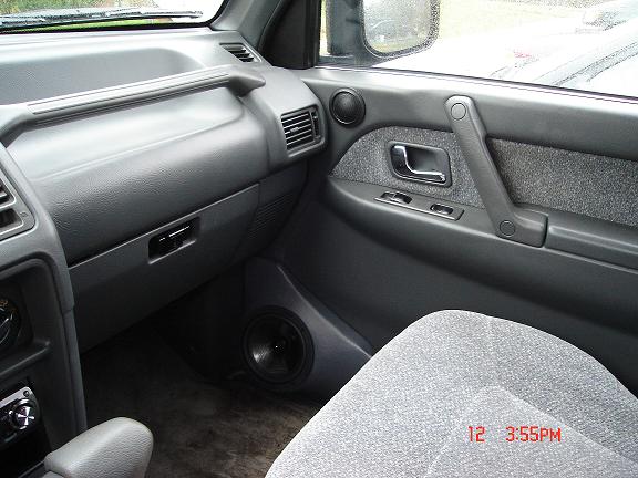

Gold Member Username: Suleman36Maryland U.S.A. Post Number: 2199 Registered: Feb-05 | Guys, all this time i thought i was an spl guy until i put my 2 JL 12w6v2's in the cargo area and my ID componant set in the front. I will never go back to just SPL again. Im a SQ guy for life. Jonathan and Isaac here is the current setup of my componant set. Tell me what you think and how to utilize the CDT because i have the install tommorow. |
Gold Member Username: Suleman36Maryland U.S.A. Post Number: 2205 Registered: Feb-05 | jonathan or isaac let me know asap if i should change the tweeter location for the CDT's for the new install today. Should i bring it as close as possible to the midrange ? |
Gold Member Username: CarguyPost Number: 4763 Registered: Nov-04 | MO, you do have some space on the door panel, just above the midrange. Just past where the plastic molding ends for the mid (corner of "L" shape), you could place the tweeter there and point the tweeters slightly upward. As it stands, your tweeter is too far away from the mids. In my car, I have tweeters in the exact location, but I also have the ones that came with the component set, half way between. With my phase timing device, it now gives excellent SQ and imaging. The way you have right now, is good for the 2nd pair of tweeters. |
