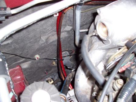

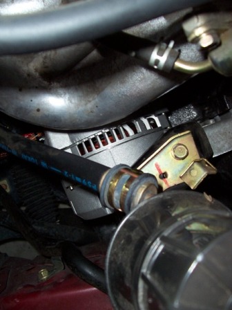

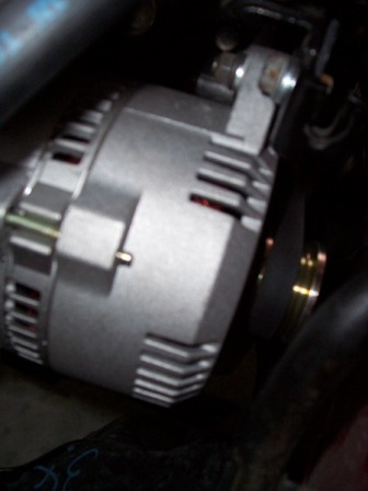

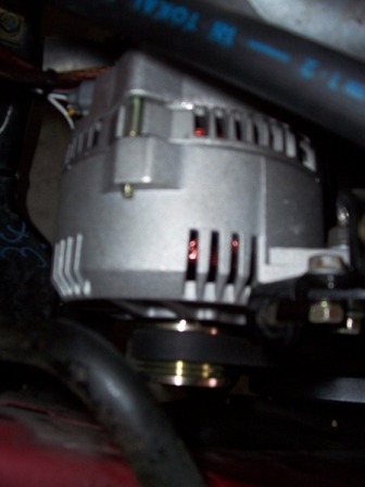

I finally got around to taking pics of my new amp and HO Alternator.
putting on that alternator wasn't the easiest thing in the world. lol
we had to make a bracket, b/c the top mount didn't line up with the factory mount, but other than that. no problems
it does 14.5V at idle, and 14.2 with my system at full blast.:-)

loooks nice man. I had to do the same thing with my alt but it was no big deal. Nice set up.

i suppose i made it seem like we were splitting atoms when i said that it wasn't the easiest thing to put on. it wasn't really hard at all, but they mislead you with the words "direct bolt-on" sometimes. lol

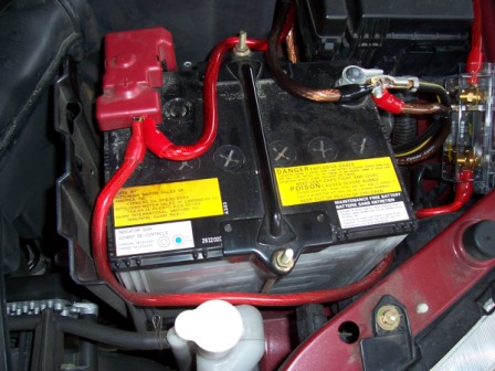

Did you run 2gauge-0gauge wire for the ground to the amp? Your car's chassis will only handle so much current.
I find that by hard wiring the ground wire from the battery, you get more consistant current flow.

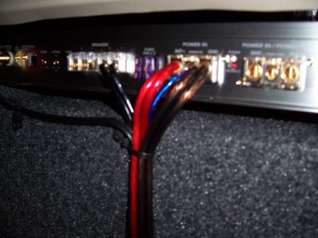

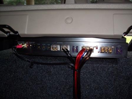

yes, we upgraded the big three.
and the ground wire for the amp is two 8guage wires.
more pics of the wires and anl fuse.
the fuse is a 250A
the ground is 2 8guage wires

there is 4guage power wire going to the D-block, and then 2 8guage power wire from D-block to the amp.

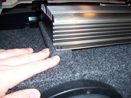

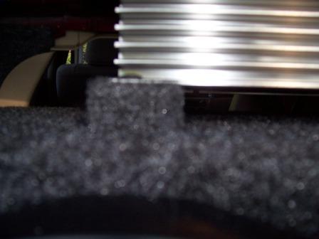

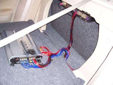

Why is that amp mounted right on top of the speaker box? It seems to me that that is a bad idea due to vibrations generated by the sub.
What kind of amp is it? I see the US Amps amp, but what is the other one?

Yah, that disappoints me that you mounted the amp one the sub box. You should know better than that :-)

It's fine. He's using a quality amp on top of the box (DLS - nice) 870wrms. And when your US amp is missing, don't look here :P!
Username: Clownass
Post Number: 32
Registered: Sep-05
Quality amp or not, the vibration is still there and in time it will take it's toll.
Username: Audiobass10
Cape Coral, FL United States
Post Number: 271
Mounting the amp on top of the box is fine. The only real downfall to doing that is the fact that it makes it easier for someone to steal your amp, box and subs all at once without much effort..yank a couple wires and they're gone..i had that happen to my first setup.
Username: Basshead86
Ocala, FL USA
Post Number: 2171
Registered: Aug-05
the amp is mounted on two pieces of wood that are carpeted. so it it not right on the box, and the inside of the box is braced.:-)
one of the guy's at my audioshop said that one of the only high-end amps he has ever had a problem with mounting on the boxes is some of the US Amps, other than that, he has never had any problems with mounting amps on boxes. they always brace the inside of their boxes too.:-O
we mounted it on the two pieces of MDF b/c i was a little concerned with "the issue", but he reassured me that if my single 10" would break my DLS amp that he would buy me another one. lol
that and the fact that the fan is on the bottom of the amp.:-O

i dont think it would be that big of a deal, however id still be worried just because i worry about sh!t, lol.

here are some pics of the pieces of MDF it was mounted to on top or the box. so it is really mounted to 1.5" of MDF, and the box is braced.

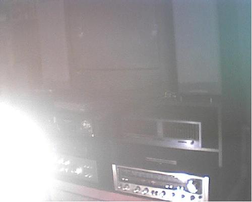

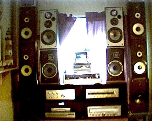

I've found my bedroom, if I leave my stereo on during the winter leaves my bedroom a good 5-10 degrees warmer than the rest of the house. THANK YOU VINTAGE KENWOOD GEAR! w00t w00t!
Username: Tdbdadrummer
Post Number: 467
Registered: Aug-05
Not to mention my computer, TV, VCR, DVD player, equalizer, computer monitor, lamps, and everything else. I keep warm with electric where gas is expensive. Downside is, I don't want to leave my room :P.

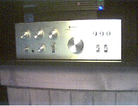

Muddy why would you punch me? Just because I have cool vintage audio gear that gets warmer than a lot of today's equipment, and keeps me warm lol. (And sounds better than today's garbage as well!)
Post Number: 471
Registered: Aug-05

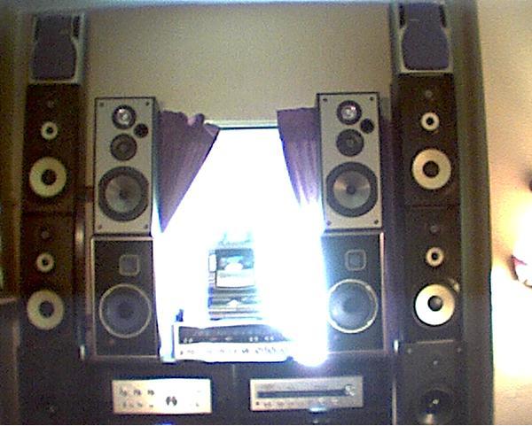

When I REALLY want the Kenwoods to heat up, I run them at higher levels with speakers I know to have a higher DC resistance, that'll make'em work hard lol, and provide my heat!

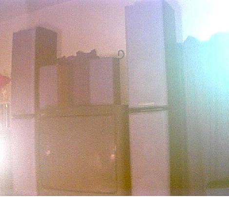

See how cool I am?
That's my bedroom sound system until I can get my power amp and Cerwin Vega V-15F's. But for now, it's plenty loud enough.
That was my stereo before I moved it around to the other side of them room and removed some speakers that didn't quite fit the overall sound and were causing major cancellation.
I know, I know, it's home audio, but I thought I would show off what I have more knowledge about. Not saying what I have now is something to brag about (except for my vintage gear) but it's nice to look at and doesn't sound half bad. Go ahead and poke fun though, as some of the speakers are Sony's. The ones on the right though, without grills and are all black with Sony sattelites on top of them, are ones my Dad built in the 80's. They have EXCELLENT SQ, especially for having strictly Radio Shack guts. I suppose that's what happens when you know your stuff!

you should get a few more speakers that way you could block out all the light. lol

Nice Steve lol. Seriously though, 2 Cerwin Vega V-15F's will get louder than ALL of my speakers, and sound better. SO I think tiny bookshelf systems are out for now, except for casual listening.

Muddy, those 2 inner pair of speakers near the top, they look like Pioneer? I recall seeing one on eBay.
Did you know that, it's really a 2way speaker? The middle is just a vent, not midrange.

what?
i don't have any Pioneer speakers.
if you are referring to the low-res pics of all those speakers, then those are Tyler's. lol

lol dang man thats awesome..both of them...agreed with the adding more speakers...and less light..lol

Isaac, those ARE actually 3-way. The midrange does produce sound believe it or not! It's a 27 ohm driver, so it draws VERY little, and produces VERY little sound, but does produce sound.
Pioneer did that to keep up with Sony's design (the yellow coned speakers) and added the midrange to give the effect of a 3-way system, but it's just not audible like the Sony's are. But the Pioneer's tweeter is much more pungeant than the Sony's tweeter. Both pairs are similar except for Sony being sealed, and Pioneer being ported. The Pioneer does have a PTC tweeter protection circuit, but lacks in bass range.
Thanks for the comment about my crappy pen cam Muddy. Some peopl aren't rich bastages! J/K! ;P

Really? The ones I checked out had air coming out of it, just like a port.
Post Number: 481
Registered: Aug-05
Are you sure that wasn't the actual 2-way model? It's smaller than the "3-way" as Pioneer claims, model.
Those particular speakers are lined up as so, midrange, tweeter, and woofer. They have a port right and in between the midrange and tweeter. They do offer a 2-way model, but I've never used/seen it.
Besides, that would be a little silly to have an actual port, and air coming out of an aluminum coned midrange. (Don't know if that's possible, and it would kill SQ, as well as the woofer.)
Home audio is where I know the stuff lol. When it comes to cars, sure, I can understand the terms, but the actual installs and what not, not quite up my alley, but I'm willing to give it a try on my 4 channel amp I get.
Do I need a D-block to add a 4-channel amp to my current setup?
But regardless, check out who's rockin' three vintage Kenwood amp/receivers! KR-2600 = 10 or 15WPC (Been a while since I checked, and can't remember). KR-6600 = 60WPC receiver. And KA-3500 = 35WPC integrated amp. So I say w00t w00t to that!
Best part is, although those are Sony and Pioneer speakers (some of them), for being mass produced cheap brands, they REALLY don't sound too bad at all. Especially if you compare them to their car lines. It's a world of difference in SQ.
