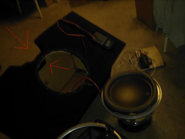

Ok, so after hearing my setup, I have a friend in a camaro (Firebirds > Camaro's!) who got a W7 himself, and had the place build a box for his hatch. Now - question... Would a HUGE hole in the box effect the SQ? His dosnt sound as good as mine, and we opened it up. First off, they only had one VC plugged in... Second, there is a HOLE in his box, near where the mechanism to hold his hatch down goes.. I took some pics, here they are..
It fits semi-tight around the hatch piece... But obviously not air tight.. Would this effect his sound performance??

"First off, they only had one VC plugged in..."
Definately use both. Using only one coil will change all the parameters of the subwoofer.
"It fits semi-tight around the hatch piece... But obviously not air tight.. Would this effect his sound performance??"
Enormously. Seal the hole up in some fashion, outline where the hatch piece goes and build a small box to seal that off.

Jonathan, these guys are JL authorized dealers...not very many of those wehre I live...wouldnt this be....something their installers should know? I hooked both up immediately when I saw the VC thing... I was like WTF?!?

Call the place first, see what they say. If they won't fix the problem, then call JL to make a complaint. From what I see of it, the worksmanship on that box doesn't look very impressive, anyway.
Anybody should know that the hole will cause SQ issues, you shouldn't have to be an authorized JL dealer to know that. A leak around one of the box sides is bad enough, that hole is just uncalled for as there is no way they could get a tight seal.

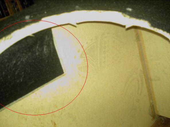

I'm looking at your 2nd picture and noticed the wood chips in the screw holes. Didn't they pre-drill it? That will insure the box won't crack and provide good seal. They must've had some high school kid build it for their project.
The box I built is air tight 100%. I not only used wood glue, but a sealer along with it on the sub frame, screws, and the speaker wire terminal connectors. The only air flow is the port.
You really need to drive down there and show the owner the box. I am sure, unless the guy is a crook, he'll do something to make it right.

Hey Isaac, did you see the snaker prints on the inside of the box in the second pic as well? Just looks kinda funny.

Yea, I think they used some left over wood from a construction site.
He should just take the box as is to the shop and them refund it completely. That's just a shabby work/business practice.

He's gonna take hte box back down to the shop today..will post with how it goes.. (Told him that if htey try to offer to only repair the box, to say no, because as isaac pointed out, the splintered wood..)

However, he's having a new box built, (since I went with him, and threw a hissy fit about the stripped screw holes.) Also, complained about them just drilling two little holes and running 10 ga wire through them, without even a speaker conection terminal, just ran them out, and put a little silicone..not even enough to keep the wires from moving back and fourth, though.
