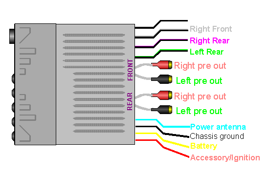

Does your unit have any wires not listed in the above picture? If it does, please list their colors...
The mute wire might be a different color...
