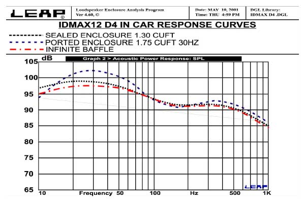

so would it wouldnt be ideal to put an IDMAX in 2.5-8 cu ft. box tuned to 28hz?(thats what they recommend for ported, and that is what i was going to do.)

i looked at this chart, and made what i could of it(which was a which is the highest line approach) and it shows that the ported enclosure is the most responsive.

Username: Glasswolf
Wisteria, Lane USA
Post Number: 10453
Registered: Dec-03
yeah that's with cabin gain factored in.. ported shoould work fine.
