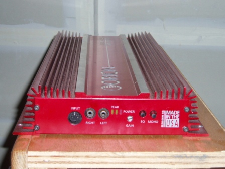

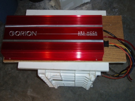

New member Username: OldskoolSumner, Washington USA Post Number: 3 Registered: Apr-05 | I believe it is a 2nd gen. Orion 250HCCA stable down to .5 ohm stereo. Took a pic of the top as well as the side. Hope that helps. With regard to the .pdf manual, I was able to download a single page with some information on it, think you might have sent me the link for that a while ago. I was thinking that there was a manual like I have seen for other amps from orion, many pages with detailed information. I could swear that I have seen them on ebay before, but I could be wrong. Anyways, on to the pics. Sorry it took so long to get them posted... |

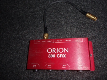

New member Username: OldskoolSumner, Washington USA Post Number: 4 Registered: Apr-05 | I have a 300CRX crossover as well, but I don't know what I would use it for.![]() |
Silver Member Username: James_gTN Post Number: 196 Registered: Jul-05 | Well, it looks like it has the DIN connectors. |
Platinum Member Username: GlasswolfWisteria, Lane USA Post Number: 10215 Registered: Dec-03 | that's a G3 amp.. good amplifier.. it probably is half ohm stable. They didn't start printing that made in the USA emblem on the end plate till third gen. same with the "digital reference" logo under the rating on top.. prior to third gen, only the SX amps were digital reference. that red 300CRX is nice.. the 300CRX is fairly rare.. a red one is almost unheard of. the problem with that XO is that it splits high/midrange/lows.. so unless you want an active crossover system with 3 amplifiers (subs, mids, tweets) it isn't much use to you except as a sub XO. Even at that you'd need all Orion amps with DIN connectors to use it properly due to the DIN level outputs and phantom power supply. as for a sub, I'd look at a single sub like one RE sub.. SE or SX line.. probably SE for your wants and needs.. good SQ sub.. get it with the standard dual 2 ohm coils.. that'll give you 1 ohm, which is what you want for that amp when its bridged for a single sub. that'd be a killer setup and you can tell people "look, its only 100 watts!" hehe |
