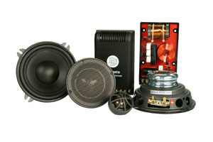

Username: Basshead86
Ocala, FL USA
Post Number: 863
Registered: Aug-05
oh, and these are the $1000 speakers. i screwed up the pic up there. those up there retail for around $800 i think.
not that it really matters. lol
