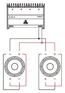

Silver Member Username: Mikechec9Chicago/atlanta Post Number: 823 Registered: May-05 | yop. with dvc 2ohm, wire them parallel like so to achieve a .5ohm load: ![]() |

Silver Member Username: SouthernrebelMonroe, Louisiana USA Post Number: 905 Registered: Mar-04 | wire each sub in parrallel, that will give you a 1ohm load per sub. then wire one sub to each channel, that will be a 0.5ohm stereo load. so pretty much wire it just like the diagram above, but wire one sub to each channel...dont bridge the amp. by the way...you have one hell of an amp on your hands ![]() |

New member Username: CadillacdbHouston , TX Post Number: 4 Registered: Aug-05 | glasswolf gave you a great link .. but if you still dont understand ill tell you how to wire two 2 ohm voice coil subs to present a 1 ohm load to your amp when its bridged .. wire them together in 'series/parallel dual 2' which would make them present a 2 ohm load to each channel of an amp but when you bridge an amp it only sees half the load so present the two ohm load to ur amp when its bridged an it will see it as a 1 ohm load ![]() |

Silver Member Username: James_gTN Post Number: 161 Registered: Jul-05 | If you wire one sub per channel and parallel the VCs, your amp will be running at 1 ohm. It will not be 0.5 ohms like someone else mentioned. If you bridge the amp, then you'll have to series/parallel your subs onto one channel for a 2 ohm load. |
