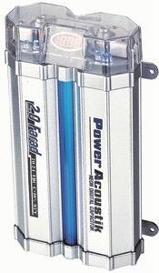

3- forget the capacitor

well as far as the cap goes I know it dont do much but I like the look of it. What do youll think of ppi or precision power amps I heard it is a da*n good amp and what brand subs do you think I shound get jl audio or something elce money will be no problem so please give me your thoughts
