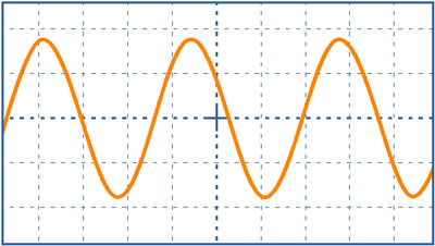

This is one frequency being played:
If you know the basics, then you would know that a speaker will move just like the wave. If you are familliar with high school math or physics, you'll probably know something about adding waves (Physics) or functions (Math). Now this is two frequencies:

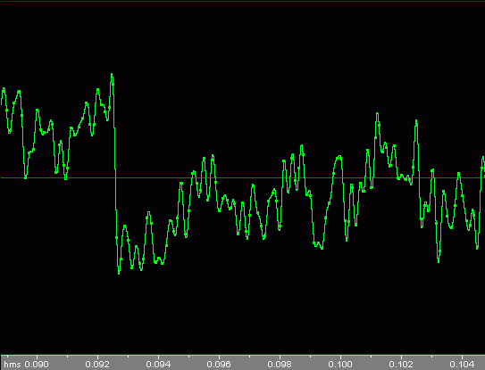

The speaker will move like the graph, but the rate at which it is moving, you can't see it very well. Now here is 6 frequencies being played together:
As the voltage changes within the coils the cone will quickly move in different directions reproducing a multitude of tones at once. Add more waves and a song is made.
