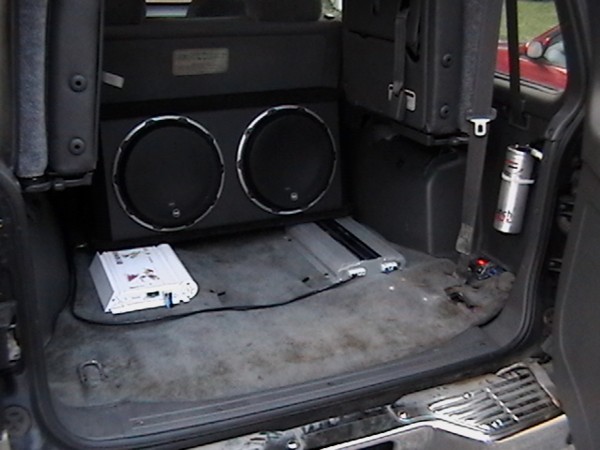

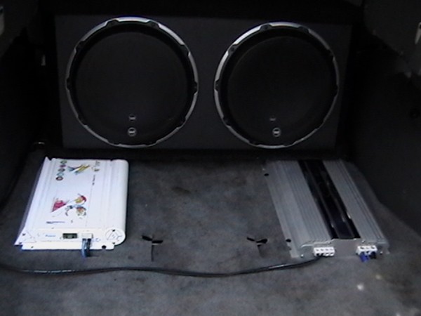

Gold Member Username: Suleman36Maryland U.S.A. Post Number: 2013 Registered: Feb-05 | Depending on if i can fit the 3.5 cuft ported box in my 95 montero cargo area with the folding seats in the back up. I will have to see if i can fit it. I have 30" W x 38" D x 42" H Here is a picture of what i have to work with Glasswolf. |
Gold Member Username: Suleman36Maryland U.S.A. Post Number: 2014 Registered: Feb-05 | Im also thinking about somthing to use to cover the amps like fiber glass or somthing that has holes so that air goes thru and that way i can lay the 3.5 cuft ported box for my SX 15 right on top and that way the amps wont over heat. I know your not supposed to cover the heatsinks of the amps so that is what i came up with. I dont wanna move around anything else but just add somthing to protect the amps and also be able to handle the weight of the ported box over them. This also hides the amps from visibility to onlookers. |
Gold Member Username: GlasswolfWisteria, Lane USA Post Number: 9320 Registered: Dec-03 | you could fire the sub upward, and mount teh amps to the back of the box so they're exposed when you open the hatch. you can use a baffle to flush mount the amps to the box.. it'd look pretty sweet like that. I've done a few SUVs that way. |

Gold Member Username: Suleman36Maryland U.S.A. Post Number: 2019 Registered: Feb-05 | Glass what could i use to create a forcefield around the amps with holes in it to have some air pass thru and that way i can just lay my sub box rigth on top of the shield of the forcefield so it wont sit right on top of the amps. I dont wanna touch the wiring or move the amps at this point. I just wanna cover them so that i can place my 15" sub enclosure over them without killing my amps from heat. Where can i find somthing like this. |
Gold Member Username: GlasswolfWisteria, Lane USA Post Number: 9347 Registered: Dec-03 | extend the sides of the sub box so it sits several inches off the floor of the SUV. that leaves room for the amplifiers under the box. then put fans at front and back to push-pull air under the box to cool the amps if you want. |
Gold Member Username: GlasswolfWisteria, Lane USA Post Number: 9348 Registered: Dec-03 | like this 4runner I did years ago: http://www.wickedcases.com/caraudio/4runner02b.jpg |
Gold Member Username: Suleman36Maryland U.S.A. Post Number: 2020 Registered: Feb-05 | Thanks Glass, that looks like a good idea. I will have the box built this way. Looks like im gonna go with the SX 15 sub from RE. Thanks again. |
