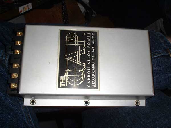

For the record, I dont have a cap installed but my put the one in that was givin to me a few days ago. Its kind of weird,it does not look like any cap I've ever seen. All it reads is The CAP by Alumapro? these anygood? its 5 Farads.
I'm not an SPL dude and only have two VGA400.2's in the truck
and a 80 Amp alternator, I just thought a cap might help keep my sound that much cleaner? I'd never buy one but I've now got one so what the heck.
Once the cap is installed and I charge it with a bulb, is it cool just to leave hot all of the time? why does Alumapro require a hugh relay?

that cap you have is an older design, and as i recall, had a fairly high ESR, so not really useful.. but they look neat at least :-)
either way its not really going to hurt anything if ya want to run it

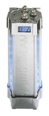

hey glass, don't mean to beat a horse but i have a soundtream SC-5CA cap. i have a 220(170) HO alt, o/1 cable, and 2 vga 1600.2's at 3000watts.
1) should i go ahead and install a kinetic 2400 battery (i understand that optimas are not optimal (npi) for high current audio systems due to resistance issues. yet i notice you run optimas. just curious if they will work in my app, or do i need the 400.00 kinetic?
3) Do you know the ESR on the cap? otherwise i will wait until monday.
but the battery will be installed tomorrow if i need it, so i appreciate the input.
thanks (it sure is purty)Upload

never had any issue with optimas, and who told you the optimas weren't well suited to audio systems? someone trying to sell you a $400 battery by chance?
no idea what the actual ESR is for the cap
RTFM is my suggestion or ask alumapro, if you can get any kind of customer service from them.. they suck at customer support.. especially trying to get them to cover warranty issues for Rainbow, whom they distribute in teh US exclusively now.
