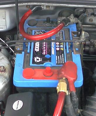

Silver Member Username: Eclipse2005Vicenza, Vicenza Italy Post Number: 146 Registered: Dec-04 | hi i know it might be not good lookin but it dont matter coz it's just for SPL porpuse. So i was wondering if anyone got any advices for making my system louder....i need more pressure...maybe i did something wrong building it so if someone thinks that i did it please let me know...im here to learn. Thanks... PS:my box does vibrate lol ![]() |
