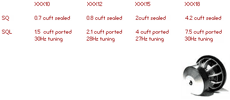

here is info about the sub
not sure what most of it means but...
i was looking at getting the 12"

i was leaning towards a ported box as well...
there will only be one sub
Username: Jechapk
Post Number: 12
Registered: Jun-05
also this is what they recomend for size and what not
