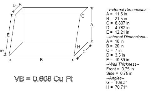

New member Username: GtechDarlington, Co Durham UK Post Number: 1 Registered: Jun-05 | Hi, Newbie to the site so please be gentle :-) I have just purchased an RE8 Subwoofer form my MR2 (Limited space), I have designed a box type: "Prism, Slanted Front" which has a capacity of: VB= 0.608 cu ft. Now the questions are: 1. Using the RE8 do I go for Ported or Sealed 2. If Ported what or how do I work out what to use ?? 3. Do I fill the box ?? Any help or guidance would be really appreciated as this is my first attempt at such a box. Many thanks Graeme (UK Subscriber) ![]() |
Silver Member Username: 54danny54Post Number: 330 Registered: Nov-04 | That is a small box so i would put about 3/4 of a bag of polyfil that u can buy at walmart...staple it 2 the inside of the box so it dosent fly around and keep it sealed |

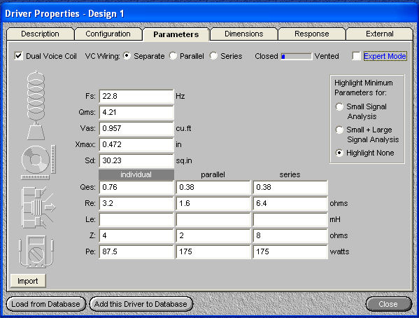

New member Username: GtechDarlington, Co Durham UK Post Number: 2 Registered: Jun-05 | Thanks guys for your help, much appreciated. Here is the specs on the 8" RE8 Sub....... ![]() |
Silver Member Username: 54danny54Post Number: 350 Registered: Nov-04 | I think it will sound good in that box...test it and tell the results also wats that program u used |
New member Username: GtechDarlington, Co Durham UK Post Number: 3 Registered: Jun-05 | Will let you know, just had notice that the sub will be delivered tomorrow morning so can't wait, rock n roll here we come :-) The program is "Bassbox Pro", really neat proggy that helps design your box, advises on wiring, etc and has a database of Subs. Send an email to gtech@f2s.com and I'll let you have more info ;-) |
