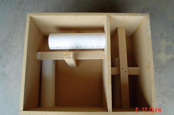

Silver Member Username: GeekbikePost Number: 118 Registered: Dec-04 | Finally got it off my camera. 5cuft for a 15" SS RL-p. Tuning at 27 and 54hz. I'll upload the installed pics tomm. |
Gold Member Username: SubfanaticWalton, Ky Post Number: 4121 Registered: Dec-04 | whoa, whbats going on here, r u sure thats an abc boox |
Silver Member Username: Addicted2bassMiami, Florida USA Post Number: 778 Registered: Nov-04 | yup thats an ABc enclousre..just with round ports |
Gold Member Username: InsearchofbassPost Number: 2537 Registered: Jun-04 | he must have it sized down lol because that doesnt look like 5.5 cf lol |
Gold Member Username: InsearchofbassPost Number: 2538 Registered: Jun-04 | 5 cf my bad |

Silver Member Username: GeekbikePost Number: 119 Registered: Dec-04 | Inner dimensions are 27.75 x 15.5 x 22.5 (excluding the center baffle). Size limit on the MB is less than 600x600, so it was scaled down to fit. |
Silver Member Username: Tdeaton1021Near Tampa, Florida USA Post Number: 534 Registered: Sep-04 | thanks for that info sean. althought isnt it missing one thing.... whats the diameter of the ports? it tells you the lengths but not the diameter... but with how, well not easy, but general, those dimensions are i might build one for my avalanche 15... i just need to know the port diameter and then make them a little longer to bring the tuning frequency down right? |
Silver Member Username: Tdeaton1021Near Tampa, Florida USA Post Number: 535 Registered: Sep-04 | and those braces arent absolutely necessary right?.... |
Silver Member Username: Tdeaton1021Near Tampa, Florida USA Post Number: 536 Registered: Sep-04 | if i can do this im thinking about tuing the 3cuft chamber to 20hz and the 1.5cuft chamber to 35... or maybe 38hz...or should i do higher? i think to do so i need to make a 3in dia. ports... make the one in the 3cuft chamber 13.68 inchs long... and the one in the 1.5cuft chamber 8.17in for 35hz...6.6in for 38hz... but about the port connecting the 2 chamber... do i leave that the same as the port for the 3cuft chamber? this pvc abc boxes look more comprehensible but yet im still confused... i need to borrow your brain sean. |

Silver Member Username: Tdeaton1021Near Tampa, Florida USA Post Number: 540 Registered: Sep-04 | a program just said the minimum diameter i could use was 8.61 inches.... isnt that huge? cant i use smaller... what diameter pvc did u use knacko? and what did that guy use in ur info u put up sean? |
Silver Member Username: Tdeaton1021Near Tampa, Florida USA Post Number: 541 Registered: Sep-04 | okay.... i guess im back to a regular ported box lol... they are confusing enough to me as it is |
Silver Member Username: Tdeaton1021Near Tampa, Florida USA Post Number: 542 Registered: Sep-04 | some day when i have money to blow im going to build a ABC box and hope i get it right and see how it sounds lol |
