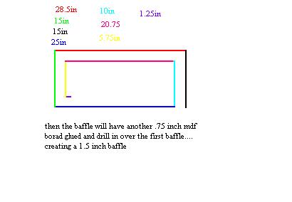

Silver Member Username: Tdeaton1021Near Tampa, Florida USA Post Number: 480 Registered: Sep-04 | okay these are exterior dimensions of the box... 30 inch width 18 inch height 15 inch depth 4.6875cuft so the port will be 3.5 inches wide and 16.5 inches tall.... and have a port length of 49.62 inches...... will that give me a 24 hz tune? im confusied i just know i want a box perfect for an ava 15 iwth a JL1000/1 and a 24hz tune lol |

Silver Member Username: Tdeaton1021Near Tampa, Florida USA Post Number: 484 Registered: Sep-04 | can a port even work like that lol i think so... and i want to coat the whole interior and exterior of the box in resin like the guy did on that site showing about the 2 chamber abc box for the 6.5s... and also i want to round the port corners with pvc and resin like he did also... i hope im not in over my head |
Silver Member Username: Tdeaton1021Near Tampa, Florida USA Post Number: 485 Registered: Sep-04 | oh and where should the sub be placed??? should it plit the distance between the end of the port and where the port begins...like this... ![]() |

Silver Member Username: AlpineuserWinchester, TN Post Number: 416 Registered: Mar-05 | when u count the volume dont count the port volume just the internals of the box |
Silver Member Username: Tdeaton1021Near Tampa, Florida USA Post Number: 489 Registered: Sep-04 | oh man i did not know that... i feel like an idiot.... so dont count this gray area.... ![]() |
Silver Member Username: Tdeaton1021Near Tampa, Florida USA Post Number: 490 Registered: Sep-04 | thats like half the volume lol |
Silver Member Username: Tdeaton1021Near Tampa, Florida USA Post Number: 499 Registered: Sep-04 | okay ... or tell me if this enclosure would work well with a 15 avalanche and a JL 1000/1... go to http://www.accelerator-pedal.com/l-ported-box.htm for net volume put 4.6875 24Hz tuning frequency i put .18 for displacement i dont really know box width 40. box height 18 im realy not sure as to what volume/shape would give me the best outcome.... |

Silver Member Username: Tdeaton1021Near Tampa, Florida USA Post Number: 502 Registered: Sep-04 | oh and that last set of specs i posted ... the program said a 2.75 in port width.. arent low tuned ports usually wider ports? |

beerman_accelerator-pedal.com Unregistered guest | Cool, people are using my program! Trevor, the program determines port area based on two guidelines for minimizing port noise: A minumum of 10 square inches per square foot, and at least a 9:1 ratio between height and width. Port width and port height make up port area. Port area and tuning frequency determine length. Tuning lower usually means it's going to move more air at resonance, and that might be a reason for making the port wider. 10 square inches of port area to a single cubic foot of airspace is usually enough to prevent noise in most cases, though I'm sure someone disagrees. |

Silver Member Username: Tdeaton1021Near Tampa, Florida USA Post Number: 550 Registered: Sep-04 | but one thing no1 answered... where shud the cutout for the sub be placed on a ported box? |
beerman_accelerator-pedal.com Unregistered guest | I put it in the center of the "red" panel. |
