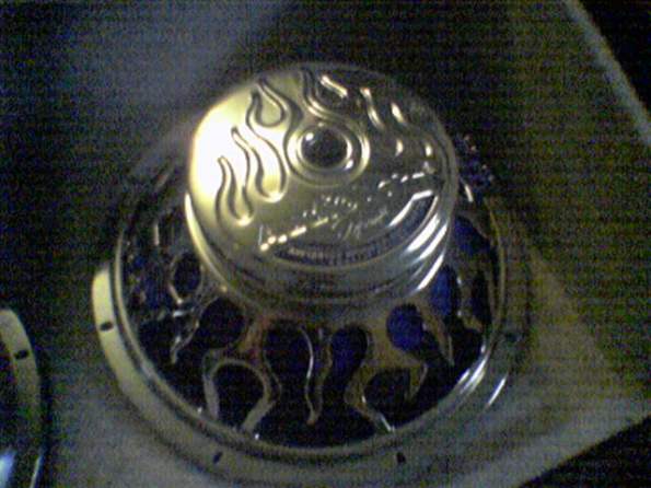

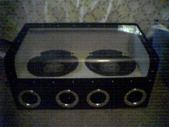

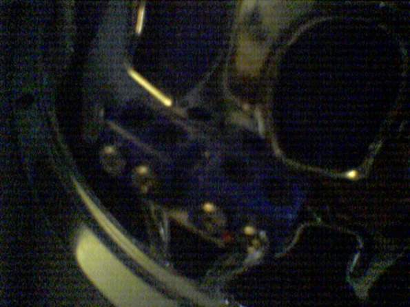

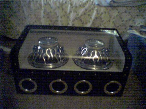

New member Username: Jerry4886Post Number: 4 Registered: Apr-05 | well i bought 2 AW1251SE subs and a bandpass box and have a few questions. First of all, should the subs be placed up like this: ![]() or like this: ![]() Additionally, I thought the subs had 4ohm impendence but they have dual voice coils so i guess they could be ran ethier as a 2ohm or 8ohm depending on how they are wired. Is this right? if it is, which would be better: 2ohm or 8ohm? Series or Parallel? While on that subject, what amp should i get for this set up for about $100-$200 (hopefully not much more)? Should I get an amp that is 2 ohm stable if it running at 2 ohms? should it be a 2 or 4 channel amp? I've read you can run 1 channel to each voice coil (4 total channels) or bridge 1 channel over both (2 channels). any ideas? now when it comes time to wire this, i'm lost. each sub has 2 dual lugs as shown here: ![]() well that means each side has 4 places to put a wire. i don't see where you would get 2(+) and 2(-) wires to put on each side. here's a close up of one side: ![]() well any help is definatly appreacited except for anyone suggesting paying someone to do it. I'll ignore it because this shouldn't be to hard to do and i like to save money...lol |
Silver Member Username: Sevin7Post Number: 123 Registered: Apr-05 | first off, it doesnt matter which way the subs are facing. Each sub has dual 4 ohm coils, wire them in togather for a 2 ohm load and you will get more power out of the amp you buy for them. This will help with wiringt: http://www.crutchfieldadvisor.com/learningcenter/car/subwoofers_wiring.html?subs =2&impedance=DVC4x2 . Also there is a guide on how to wire your subs in the back of your subs user's manual. each voice coil has a + and - terminal. Each of those terminals has 2 inputs, simply to make it easier to wire both voice coils togather. So you would want to put the + wire coming from your amp into one of the + terminals, then on the same side, put a short wire into the other + terminal, and run the other side of that wire to either one of the + terminals on the 2nd voice coil, this would be how you wire it in parallel. Buy this amp for those subs: http://cgi.ebay.com/ws/eBayISAPI.dll?ViewItem&category=64571%26item%3D5774420253 %26%26 |

Bronze Member Username: ShawnomakHB, SK Canada Post Number: 24 Registered: May-05 | i dunno is this is right, but i heard if ur gonna put ur subs in the box like the first picture, wire ur subs - terminals to ur amps + terminals so they are pushing out the same time ur speakers are.. it will sound better. |
Gold Member Username: InvainMichigan United States Post Number: 2413 Registered: Aug-04 | Shawn I'm still trying to figure out what your talking about....? "so they are pushing out the same time ur speakers are.. it will sound better." So the subs push out when all his other speakers are?? Is that what you meen? If that's the case, it doesn't matter. As long as the subs are in phase, it doesn't matter how his subs are in the box. |
Bronze Member Username: ShawnomakHB, SK Canada Post Number: 26 Registered: May-05 | i heard that from a guy in town here at a car audio shop... if the subs are placed like that, they are pushing into the box as the other speakers are pushing up. i dunno if hes right, but he said it will sound better. i didnt think it would matter but i thought if he was an expert and im new at this, id go with what he said. |
Bronze Member Username: ShawnomakHB, SK Canada Post Number: 27 Registered: May-05 | was that guy right, or should i go pimp slap him for being so stupid? |
Gold Member Username: InvainMichigan United States Post Number: 2416 Registered: Aug-04 | Go pi.mp slap him. Like I said, if everything is in phase, it will sound the same no matter which direction it's going. |

Gold Member Username: InsearchofbassPost Number: 1999 Registered: Jun-04 | if you invert a sub you should reverse the polarity |
New member Username: Jerry4886Post Number: 9 Registered: Apr-05 | sorry if I'm not an expert and probably sound dumb but what does that mean? are you talking about the direction they are facing in the box? |
Gold Member Username: InvainMichigan United States Post Number: 2476 Registered: Aug-04 | Yes Jerry, you need to reverse polarity when you invert the subs, other than that they have nothing to do with how the subs sound. When you reverse polarity, you simply switch the + and - terminals, as if you wired everything backwards. As for what Seven7 said about the sub positions and wiring, he obviously hasn't a clue what he's talking about. Like I stated before, it DOES NOT matter which way the subs are facing, magnets in, or magnets out. This in no way effects how you wire the sub, except for reversing polarity. |

Bronze Member Username: BasshdPost Number: 45 Registered: May-05 | In an "inverted mount" such as is shown in the first picture, wire the sub the same as if the sub is mounted the "regular way". It makes no difference. If you wire them backwards just because they are inverted mounted then you may get cancellation. Also remember when you invert mount subs the enclosure volume will change a little, because you no longer have subs magnet and basket assembly taking up volume within the box, and actually you will gain enclosure volume because the concave cone of the subwoofer "adds" volume to the enclosure, hence the tuning of the enclosure can change when inverted mounted. |
Gold Member Username: James1115Wilton, Ct Post Number: 2986 Registered: Dec-04 | thats tru displacment will play a factor but when in a box built to manufac specs that might make it sound worse and a bit boomier. If it was built to spec it would dampen SQ on a sub that already has No SQ to begin with. |
