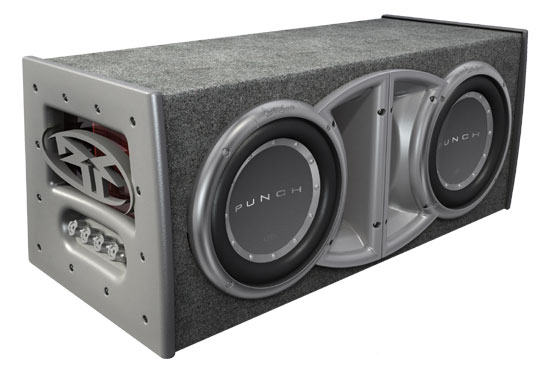

New member Username: RfrulesCanada Post Number: 1 Registered: May-05 | Allright well my car has gone back to the shop for good and now i have my 6 month old system i bought for a crap load of cash and it is just sitting my room. Now i want to hook it up some how in my house and i know it is possible so i would like some tips and i also heard something about a computer power supply??? thx guys![]() |

New member Username: Subzer0Richmond, KY USA Post Number: 7 Registered: May-05 | I see this on ebay.. sometimes.. I forgot what I search for but that exact picture pops up almost every time.. lol. |
