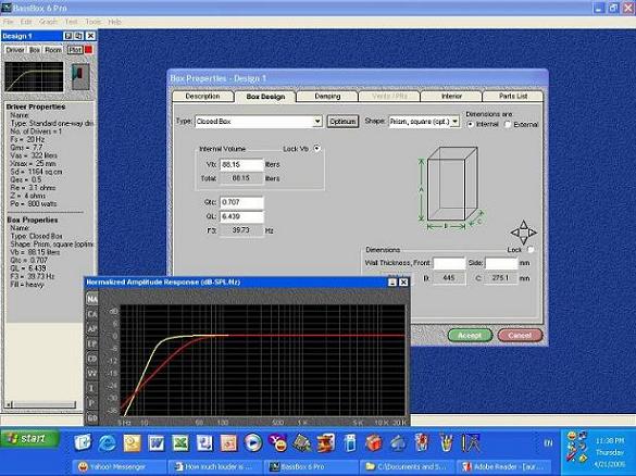

Bronze Member Username: MixneffectOrangevale, Ca. USA Post Number: 54 Registered: Apr-05 | Here is an example of the difference between a sealed box (red) and a ported box (yellow).![]() |
Bronze Member Username: JbaileyIndianapolis, Indiana Post Number: 54 Registered: Mar-05 | Hey mixneffect, what is that program you're using for the box design and, if possible, where can I find it online? Thanks |

Bronze Member Username: MixneffectOrangevale, Ca. USA Post Number: 55 Registered: Apr-05 | The program i use is called BassBox6 Pro. This program is ok. It is not the best program, but it is great for box building. It beats the slide rule ... lol You can find it at www.madisound.com for about $180 |
