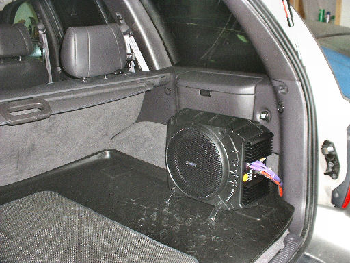

New member Username: Jrodrig692Post Number: 4 Registered: Dec-04 | Can the amp then be placed under one of the car seats? The Basslink where does it go. What I mean is it stand aloneor in a box? Can a sub be placed out like a speaker is? Thanks for all the help. |
Gold Member Username: GlasswolfNorthWest, Michigan USA Post Number: 6664 Registered: Dec-03 | if you don't have power seats, and have plenty of room for the amps to get air, they can go under seats, yes. thre are subs made to be used "free air" but they all suck badly. a sub needs a box for proper suspension. the basslink is entirely self contained. The enclosure, subs, and amp are all in one package. you just run power, ground, remote, and RCAs to it. here's a picture of one in my jeep: ![]() |
