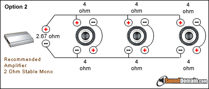

Okay I must be missing something in here. If you look at the pic above, option 2, it says 1.34ohms. So Help2, how do you get .67ohms using 3 4ohm DVC subs? According to the diagram, if you turn 4ohm dvc into 2ohms, and then connect them in parallel, you're suppose to get 1.34ohms. Is my logic way off?

the diagram shows 1.34...thats when u start off with 2 ohm subs. i dont have 2 ohm subs..

Ok now it makes sense. See what happens when you get all the facts :-)
