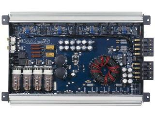

Bronze Member Username: AvalanchePost Number: 35 Registered: Nov-04 | Humm so what you are saying Glass is that the TU4360 is more trouble than it is worth. I thought that It would be a great amp for High's I might have to rethink that strategy them. I am posting a picture so everyone knows what I am talking about. I thought this would be a great amp for high's truelly. ![]() |
Gold Member Username: Jonathan_fGA USA Post Number: 2638 Registered: May-04 | If you're willing to maintain it and like the sound of tubes, then it's a great amp. It's well built and sounds good. BUT, remember it's a tube amp and if you don't like tubes, then you're better served with solid state. |
