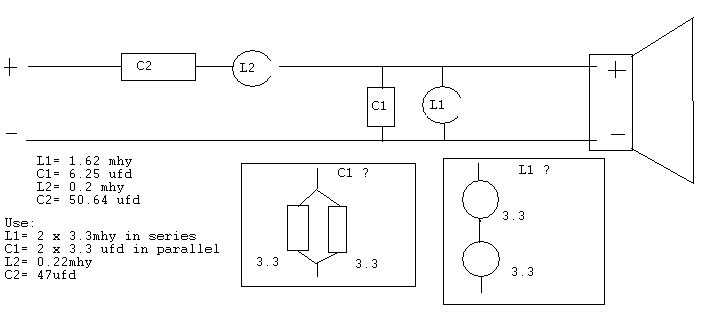

Bronze Member Username: Jwbulger79Post Number: 28 Registered: Nov-04 | thanks glass. i've been doing some research. i calculated the proper coils and capacitors on 12volt.com (see diagram). it looks like i will need to do a parallel and a series hookup to achieve the proper numbers. is the setup in the boxes the proper way to do it? the only place i could find that sells the coils and capacitors is sourceresearch.com will you tell me if these are the right parts? coils: http://www.sourceresearch.com/fastron/Fastron-pdf.cfm?pdfpage=Msmcc.pdf capacitors: http://www.sourceresearch.com/xicon/xicon-pdf.cfm?pdfpage=xal.pdf any other places that sell these that you can think of or how i can search for sites that do? i should solder these then wrap connections in electical tape? thanks again for all of you help.
Gold Member Username: GlasswolfNorthWest, Michigan USA Post Number: 5939 Registered: Dec-03 | try these guys http://www.audiowarehouse.peachhost.com/Home.htm they sell PAC Audio stuff. e-mail them and see if they carry PAC coils and caps for building passive audio filters. |
