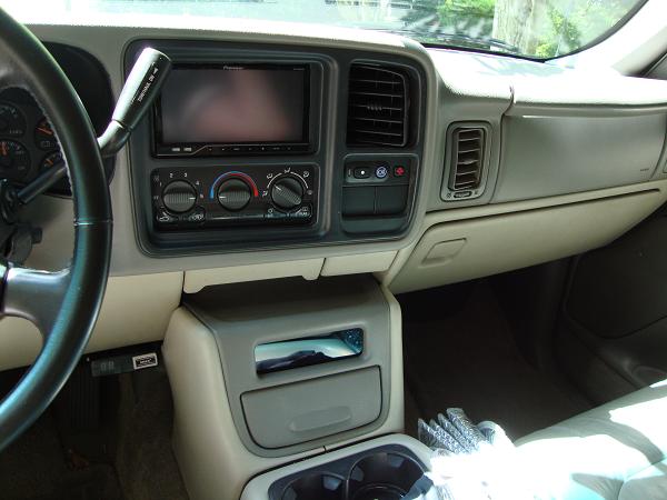

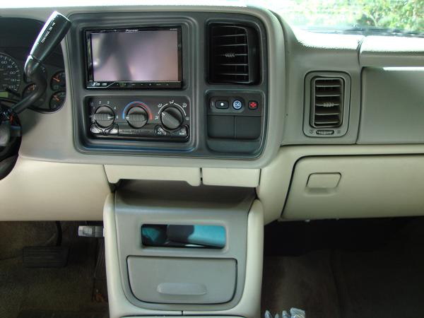

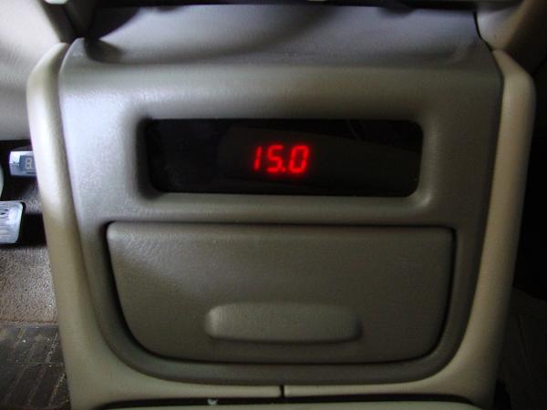

It's been a while since I've updated, I installed the double din in the dash, that's been working good. I figured I'd finish up all the dash work, which really just means installing the XSPower Voltage Control Module.
Pics:

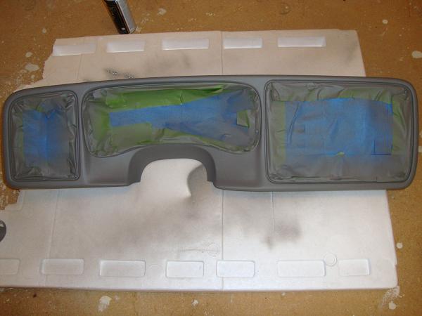

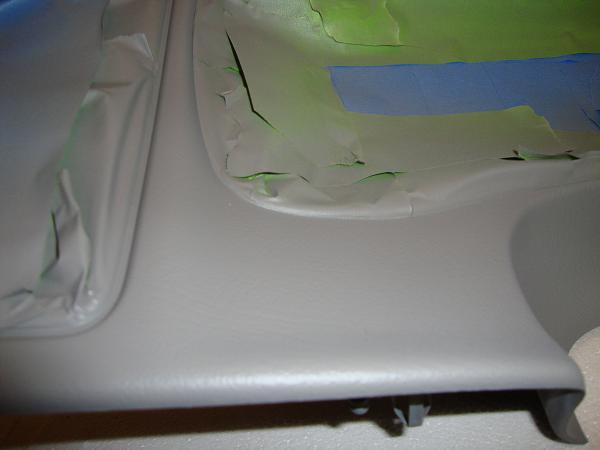

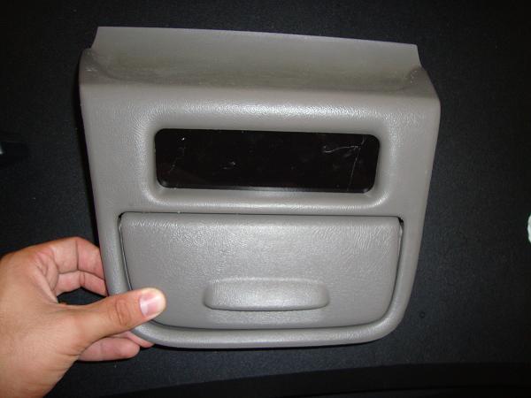

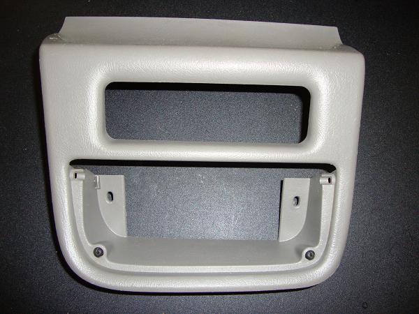

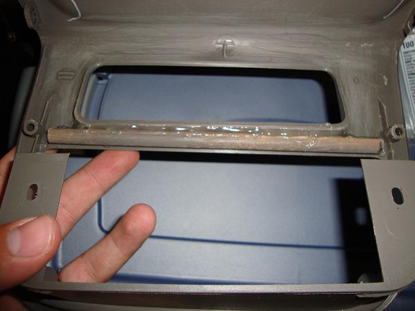

I picked up a spare part I didn't mind messing up, I might do things differently if I'm not happy with this
Scuffed up

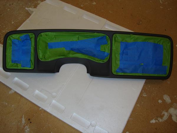

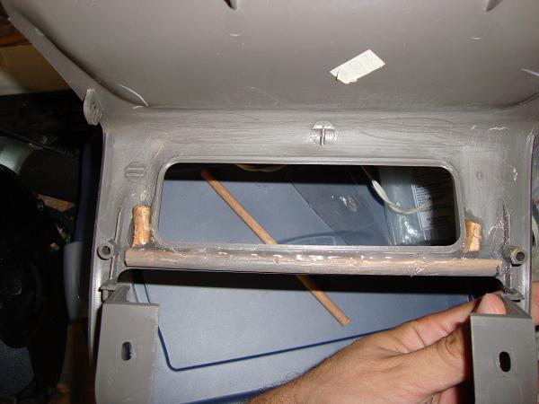

I couldn't find smoked plexi anywhere locally, and I really wanted to see what I was buying to be in control of the level of darkness.
I used tail light paint to black out 1/8" plexi

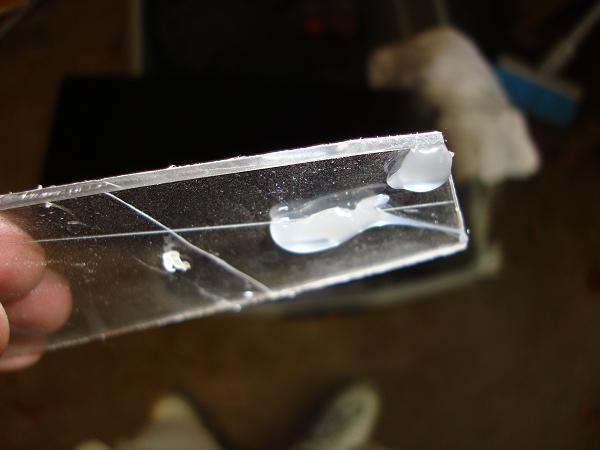

I used dowel rods to build up the frame a bit with hot glue, I tested it and it holds extremely well for what it is, I can't get it off without using a razor knife and just cutting it.
I tested the glue on a scrap piece of plexi, it holds great by itself, I couldn't get it to pop off.
And the finished product, I didn't notice the hot-glue string I'll have to clean off the plexi- but other than that it's in place.

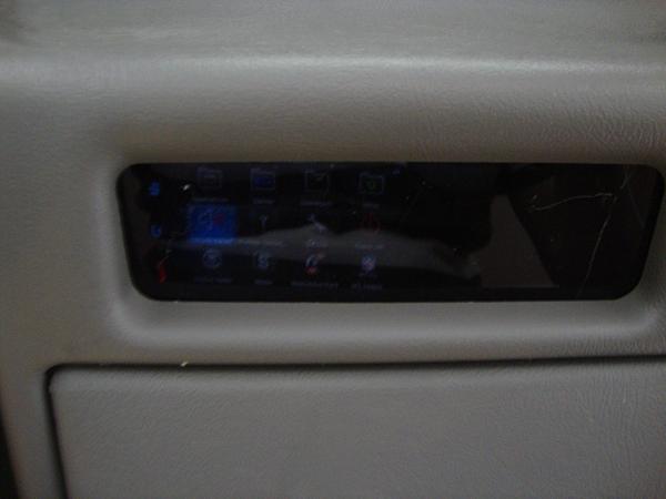

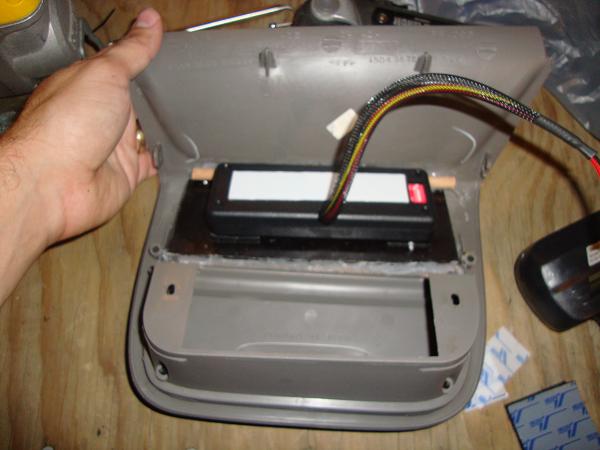

I stuck my phone behind it to give an idea of how the display of the module will still be visible when the car is on- just enough to see it without being irritating at night.
I'm still not sure if I may 'glass this thing in place instead, I'm going to fit this in my truck and see how I like the look of it. Any opinions welcome- I'm debating if I like this or not.
I cleaned up the plexi and installed the piece, without the module just to check it.

Thank you. It was extremely easy, I'm just debating if I should paint the cig lighter cover and ash tray to match the dash and make a connection between the two matching dash pieces. My 70 year old mom told me she thought it came factory like it is, but I don't know. I just want it to look clean and factory.

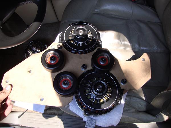

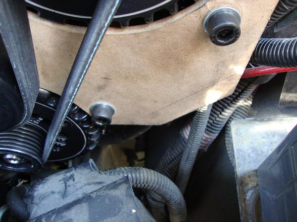

I did some alt work 2 days ago and I'm just now putting up some pics. I bolted in the bracket and it fits good other than 3 spacers needing trimmed some. Then the 127.25" belt was too short so I bought a 136.5 I'm going to try tomorrow.
If things fit good I'll be getting this bracket made asap, if not I'll be redesigning or buying smaller pulleys.

I think that looks very clean and factory. If you can still clearly read through the tint without it being obnoxious then thats a great idea.

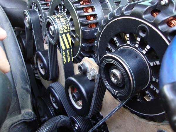

Okay, it may not seem like much but this is another 2-3 hours of work today. End result is I'm ready to have this bracket machined! I'm in bunches
Figured out the location of the pulleys to get good tension.
That line represents a 90 degree bend in the metal on the real bracket.
Belt wrap?

id'e be really pleased with how that turned out if i were you. that looks great!
good job man, be sure to post pics of the machined bracket when it gets done. again great job, 3 thumbs up.

That set up looks amazing. Great work.

Thanks everyone. I'll probably clean the template up today, then run it down to the shop tomorrow to get them to start working it up.

I dropped the bracket off for auto cad and laser cutting. I'll know prices tomorrow.
If anyone is interested, the more I buy the better price. I buy one, test, and offer group buy or presale pricing on dual, triple, or quad brackets for 01 tahoes. We're talking like 1/2 the price of buying from a huge company, with all of the quality.
Anyone thinking about upgrading speak up as soon as possible, I'll be posting pictures as soon as I have a first run of things in my hands. The more people buy, the cheaper my costs for my personal bracket, so speak up guys.

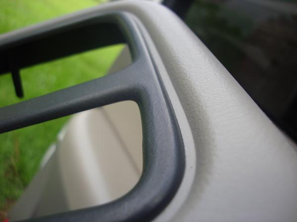

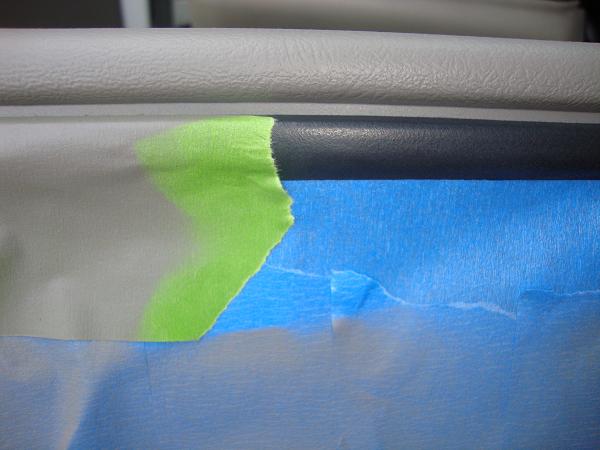

I did some work on my dash, so I figured it would be more appropriate in this thread.
I didn't like the way the last dash bezel turned out- it had a weird texture and the humidity caused it to orange peel when I painted it. I bought a new one and painted it in a vacant house- temp and humidity controlled.
Same stuff, but it was tedious work taping things off so I'm posting it. As soon as the alt bracket is done I'll finish the console to fit the VCM and have pics.
I've considered other colors/smooth but I want things to look factory.
Username: Tejcurrent
Post Number: 2318
Registered: Apr-07
I realized I skipped a few steps. I used vinyl prep spray and scuffed things up with 600 grit sand paper before painting.
Username: Mystre
Pemberville, Ohio USA
Post Number: 248
Registered: Sep-05
Looks good. Nice job.
Post Number: 2323
Registered: Apr-07
Thank you! Man, honestly this whole dash swap thing was very affordable. The scrap plexi was waste, but you can get a piece for like 10 dollars. 10 more for the paint, and 30 more for a junk-yard console so you don't have to alter yours and you only have 50 bucks in parts.
The dash was 40 dollars, the cage was another 10-20, the spacers were 5, and the paint/tape was 20. All together I didn't spend more than 150 on the whole deal. Now the double din itself I don't count because you need a h/u anyway, right?
I appreciate the compliments though, I try to make things look good when I can. My wife never has anything good to say about my work so the compliments I get online are all that keeps me going

lol, thanks. My wife actually complimented the pics I'm about to post! It took me off guard
The final product:

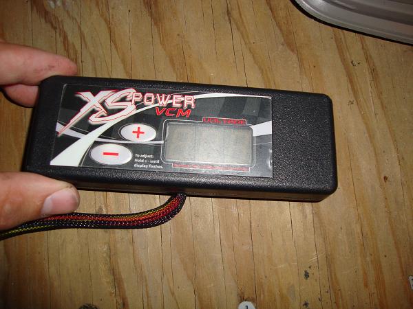

I got industrial strength velcro. This stuff is no joke, a 1 foot piece of it held over 100 pounds! I'm using large pieces so I have wiggle room to make it look good.
The module
Mounting surface
Velcro in place, ready to adhere
A little offset to appear centered

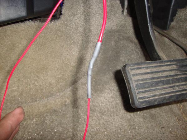

Wiring ran
And soldering a wire from the steering column.
The console before powered up.
Final product
There is a way to brighten the display, I might do that in the future because in direct sunlight it's a bit dark. At night it's perfect though, so I'm not sure. When cold my voltage is 15.3, but hot it's 14.8. I'm going to see how it goes and probably increase the voltage to 14.9 or 15 when hot.

Thanks! I turned up the brightness on the module a bit, it's not that different but enough to be more visible during bright sun light with the windows down. It's so dark with the 5 + 20% tint I have it's really only an issue with the windows down, and when giving demos and doing hair tricks that's the fun part
