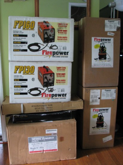

quentin.. you need this right here on the right...
... man i gotta get rid of some stuff :-(
Ideal applications include plumbing, ranching, farming and HVAC. Takes the 5,620 degree flame to the job.
COMPLETE WITH:
• WH260C Series Torch handle with built-in reverse flowcheck valves Flashback Arrestors
• 150 Series Cutting attachment
• 150 Series Oxygen/Acetylene regulators
• #2 Welding nozzle welds to 1/8"
• #0 Cutting tip cuts to 1/2"
• 3/16" x 12.5' dualine hose, goggles/shade #5 and striker
• 10 cu. ft. "MC" acetylene cylinder and 20 cu. ft. "R"oxygen cylinder (shipped empty)

Where the fluck do you get all this cool stuff Kevin? If I needed it I would Paypal you tonight lol.
But I don't.
