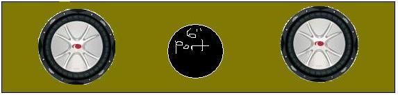

ok so i went to that site Rovin suggested but i see that slot ported boxes take up a whole lotta space so im just going to do a pvc ported box. Im going to be using a 6" port so could this work? Upload
Username: Rovin
Trinidad & T...
Post Number: 7048
what i rec u doing each sub with its own separate chamber/volume space - NOT a box that has both subs using 1 air volume, all it costs u is an extra pic of mfd .
They r lazy ppl who will follow my post saying 2 subs in 1 airspace is fine - ITS NOT ! separate has advantages , let them go read y cause i'm not gonna type it out 4 them .
3" pvc ports r good 2 work with as 4" tend s too be quite long - play with the nos on the calc 2 see what fits ur needs best .....
