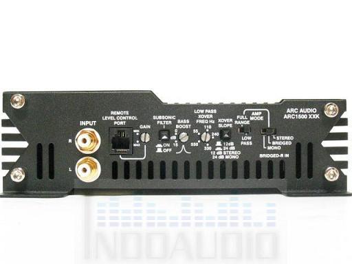

Ok this is what im working with in my system -
-Pioneer Premier 860
-PPI a600.2 for my CDT HD62 component set
-Arc Audio 1500-XXK :
900x1 @4 ohms bridged & 1,000x1 @2 ohms bridged -
Microprocessor controlled Selectable 12/24dB crossover rolloff Remote digital bass boost gain w/led status display Sub-sonic filter Frequency response 20Hz-20KHz Tripath class t circuitry Electronic load sensing for optimal power output performance Enhanced 1 ohm mode Protection against: reverse voltage, over voltage, speaker short, and thermal overload
Im using the HU crossover HPF for my front stage at 12db @ 80hz
I plan to use the crossover on my XXK-1500 to my ID MAX 12 subwoofer sealed.
Should the crossover be set at 24db @ 80hz for the LPF on this particular amp ? I dont have a option of 18db slope on the amp but i do on the HU but i think im suppose to set the lpf on the HU to full to turn it off right ?
