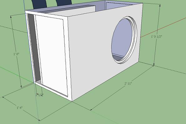

Gold Member Username: TejcurrentPost Number: 2593 Registered: Apr-07 | What amp are you running? I didn't really see anything wrong with that box either. Power you're using is important to determine exact specs I would use. I'm not sure what would be best for you- I've seen a lot of guys running sub forward port on passenger side and it sounded awesome. One of the loudest single 12 <1000 rms vehicles I've sat in was a box built in an extended cab s10 sub forward port side. |
Gold Member Username: TejcurrentPost Number: 2594 Registered: Apr-07 | Uploaded the wrong image: |
Gold Member Username: TejcurrentPost Number: 2595 Registered: Apr-07 | Just to give you what you asked for: Double baffle, sides are counter sunk .25" each, this is 4ft net tuned to 32Hz with 50sq of port after all displacement figuring .2ft for the sub displacement since a quick search didn't turn up that info. You could make the port a bit larger if you wanted. Also using 2 2x4s for bracing on the face to the port, and one from top to bottom mid-box. Dims are 16d x 20h x 35w, port 20 x 2.5" The actual board used to make the port is 25. quick sketchup ![]() |
