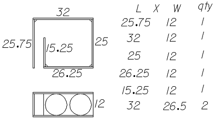

Silver Member Username: Kingandsons07Lincoln, Nebraska U.S.A Post Number: 663 Registered: Feb-07 | hey need ur help me and BCS are going to make a new box for my 18"Q and need a design! 10cuft @ 28Hz 40w x idc tall x 31D thanks Dave |

Gold Member Username: DrivingrecklessDD 9515f, 148.2 db Mov... Post Number: 5485 Registered: Apr-06 | ill get right on this. |
Gold Member Username: DrivingrecklessDD 9515f, 148.2 db Mov... Post Number: 5489 Registered: Apr-06 | 10 cubes 28 hz 95 sq inches of port area ![]() |
Gold Member Username: DrivingrecklessDD 9515f, 148.2 db Mov... Post Number: 5490 Registered: Apr-06 | when your building the box try to get the sub as far from the port as possible. but give it about 3"s from the edge. |

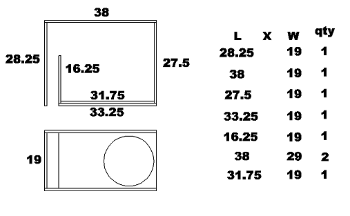

Silver Member Username: Kingandsons07Lincoln, Nebraska U.S.A Post Number: 687 Registered: Feb-07 | ok thanks dave i'm going to have fun with can i ask one more fav i got a work van and i got 2 12" re se in the in a per fab box and i want some thing better can u design one for them i'm trying to keep sub's and port back i'll get the demencins right quick thanks! and don't i need a brace for the 18"Q? |
Gold Member Username: DrivingrecklessDD 9515f, 148.2 db Mov... Post Number: 5492 Registered: Apr-06 | it is a big box..what i would do is buy threaded metal rods and put one spanning the box horizontally and 1 vertically. also note the double baffel. just give me the max dims and ill have that drawn up quick. |
Silver Member Username: Kingandsons07Lincoln, Nebraska U.S.A Post Number: 688 Registered: Feb-07 | 38w x 20h x idc deep |
Silver Member Username: Kingandsons07Lincoln, Nebraska U.S.A Post Number: 689 Registered: Feb-07 | i'm looking to get what i can from the sub's sql thanks |
Gold Member Username: DrivingrecklessDD 9515f, 148.2 db Mov... Post Number: 5493 Registered: Apr-06 | 4.75 cubes net 35hz 65 sq inches ![]() |
