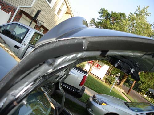

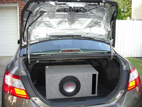

Silver Member Username: Mike11202Sewell, NJ US Post Number: 791 Registered: Nov-06 | Wolfman I think ive about mastered this by experiment after experiment now lol I sound deadened my trunk LID, then all around the edges I stuck thick weather foam there. Eliminated all my rattles and I have a small spoiler as well. So say this smiley is the trunk lid ![]() I have 4 screws in my liscense plate and also lined the back of it with thin weather foam. Make sure you tape all around the edges of the sound deadener so it doesn't stick to anything. Only rattle I have is where the window meets the rear deck and the roof-lining where the window meets. |

Silver Member Username: Mike11202Sewell, NJ US Post Number: 802 Registered: Nov-06 | ![]() |
Silver Member Username: Mike11202Sewell, NJ US Post Number: 803 Registered: Nov-06 | yeah same thing, i think its about 3/8" thick and 1" width. just go to lowes they should have the exact same thing from Frost King |
Silver Member Username: Mike11202Sewell, NJ US Post Number: 805 Registered: Nov-06 | ![]() |
Silver Member Username: Mike11202Sewell, NJ US Post Number: 806 Registered: Nov-06 | ![]() |
Silver Member Username: Thumpinwith8s2 RE8s, 300 watt Jense..., 133.3db@49hz!! Post Number: 320 Registered: Jun-07 | THANKS for the pics, mike, gonna have to try that this weekend. but what did you use for the deadening on the lid? |
Silver Member Username: Mike11202Sewell, NJ US Post Number: 807 Registered: Nov-06 | eDead V1 SE2 |

Gold Member Username: The_image_dynamicSan Diego Post Number: 2247 Registered: Dec-06 | Looks to me like eDead or fatmat. Wolf, fill up all of the hollow areas of the trunk lid with some expanding foam... smooth it out to create a flat surface and then apply your deadening over the top. Then do Mike's trick and like he said don't forget to dampen the back of your license plate. |
