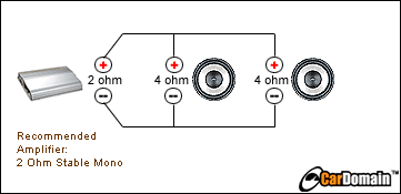

SPLSQ Unregistered guest | I am going to get a mono amp, its 2 channel and stable at 2 and 4 ohms. My subs are 4 ohm single voice coil, and I want to connect them to the amp at 2 ohms. I need someone to make a picture of how I would parallel wire. |

Bronze Member Username: LangnerMadison, South dakota US Post Number: 96 Registered: Apr-05 | yes you can if you have 2 subs ![]() |
SPLSQ Unregistered guest | You see, you have to read everything, MONO amps are not 2 channel, they are ALL 1 channel (how come no one said that before) anyways the amp mono amp that I am going to get looks like a 2 channel amp, but actually it parallels in side the amp. Like the pic. http://pic17.picturetrail.com/VOL809/3228131/6595604/93959061.jpg |
