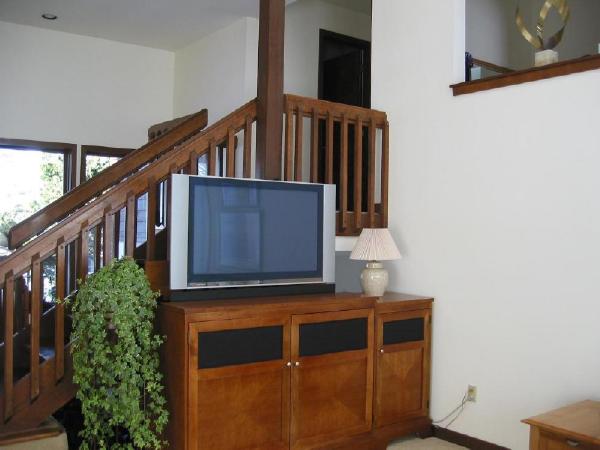

My wife said I could ahve the plasma but nothing can show in the living room. Okay, where is it:
Nothing up my sleeve, just a Hooker Furn cabinet
Now with the SONY KE-42XS910 showing:
TV open and ready

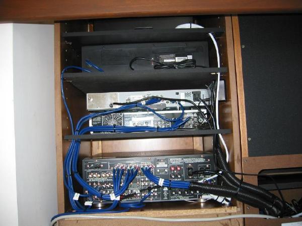

I tried to keep the wiring clean:
Wired using all optical digital audio

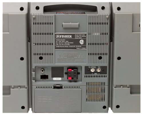

I have a really simple problem. I don't know how to hook up my audio speaker to my stereo. I just purchased a Fisher Slim-1500. The wire behind each speaker is a long gray wire that ends in two thin threads. The instruction manual says simply where to attach the threads but not how. Looking at the back of the stereo it isn't obvious to me how.

Is it the system in the picture here? I think you need to push down on the red or black lever, then insert the wire into the slot that is created. The small wires should have a solid and a stripped cover. Make sure you hook the same ones to red and the same ones to black.
Fisher Slim 1500 back panel

The speaker wire goes from the red on the component to the red on the speaker-and black to black--if there is no color on your speakers red goes to + and black to -.you can insert the cable into the component till it stops,or just short if you wish(making sure the wire is stripped of its insulation so the wire contacts).

nice how you concealed everything but if you wanted to get picky theres a imagin issue there with the center channel bein off the center of the tv lol jus had to say it but beside real neat very sharp

Ed - Imaging? His speakers are no more than four feet apart. It does look nice though.
Let me suggest you dress the cables so the AC cords cross the interconnects at right angles to each other.

I like your cable mamagement as well, what kind of interconsct are you using. Do you have component video or HDMI/DVI runing to your TV from your DVD etc?

For the LCD, I'm running the SONY DVI cable as the main feed from the SONY Wega box to the monitor. On the plasma, I am running a Marantz 7400 which has component feeds to the SONY Plasma and handles all of the audio and video switching.
Both pictures seem equally crisp in High Def. The XBR LCD box seems to do a little better(clearer and sharper) job resizing analog signals to the screen dimensions. But that may be a factor of a 30" final form factor versus 42".
