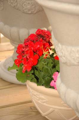

New member Username: BecauseyouloveBucks county, Pennsylvania Usa Post Number: 2 Registered: Apr-06 | Nikon D70s Help! Colors Messed Up! After 30+ years of photography experience, I've gone to digital this year. My issue is the terrible color I'm getting from this camera. In my opinion, it's like going back to 1975. No, it's worse than 1975. Anyway, I've uploaded a photo taken this morning to show my issue. If it doesn't upload, let me describe it.... The exposure is perfect to my eye. Particularly the leaves of the plant and the wood on the deck. The color of everything, but the red flowers is great... But look at the red flowers! The red flowers are nothing but a big red blotchy 'glob'. This exposure on the flowers looks ok. Everything else in the image looks great. But, there is absolutely no textures or tones to the flowers. The image is 3000 x 2000 pixels, set at fine jpeg, and you would see the same thing if you could see the full size image. I'm using a Nikon D70s around 100th second f4.5 200 'iso' if I were using beautiful Kodak Portra film, or Kodachrome 64 film, I would be finished listing at this point -- errr I wouldn't NEED to list. But, alas, let me add that there are also ... 1,000 other 'digital' permutations too numerous to list Please Help!! It's kinda like using 1,000 menu settings to drive my car instead of a steering wheel. Sometimes I end up in Kansas because of setting #563 or possibly #722, nobody can say for sure. Can you recognize if I've done something wrong? Maybe some setting inside some menu? Anything? Thanks ![]() |
Silver Member Username: ClaudermilkPost Number: 330 Registered: Sep-04 | The red channel is blown. It's the most sensitive in digital & the first to go. Try reducing your exposure a bit. Digital is even pickier than slide, so has to be right on. I am assuming you are shooting in JPG; this is an example of why I climbed the RAW learning curve--the blown red channel can be dealt with in RAW conversion fairly easily. For shooting in JPG really all I would know to do is reduce exposure a bit, then bring the overall brightness back in post processing (play with curves in Photoshop). |
New member Username: BecauseyouloveBucks county, Pennsylvania Usa Post Number: 3 Registered: Apr-06 | Thanks for the info Chris. It makes perfect sense and will certainly help very much. But, crying out loud ... When I took that photo at about 7:00am the scene was as low a contrast as you can get, in shade, with 'sweet' morning light. I just went outside 11:00am with my beloved film camera and spot metered on the deck wood and flowers in the same scene. They are still in the shade, but perhaps more contrasty than at 7:00am because the sun is higher now. Yet, there is STILL less than 1 stop difference between the deck wood and the red flowers! I'm about ready to vomit. The D70s can't handle an exposure latitude of 1 stop ?? Yeah, that would certainly be less forgiving than slide film. (By the way, I believe that that slide film has a HUGE latitude. But that's another issue.) Why wouldn't Nikon design the camera's firmware to reduce the red curve if it's that sensitive ?? I don't have the time and especially not the interest in adjusting RAW files all week long. As Bones used to say on Star Trek, "I'm a photographer damnit!". Oh, wait, or was it something else? Is there any other way around this, maybe some setting buried in some menu somewhere? Thanks much Chris. |
New member Username: BecauseyouloveBucks county, Pennsylvania Usa Post Number: 4 Registered: Apr-06 | Oh, one more thing, the flowers were one stop DARKER, not brighter, than the deck wood (as seen by the film camera)! |
Silver Member Username: ClaudermilkPost Number: 331 Registered: Sep-04 | Wow, what mode was the camera in? I'm wondering is it's set to be highly saturated, which would blow the red channel early. I wouldn't expect that kind of situation to blow the red so badly. Maybe Berny can chime in here--he's the resident Nikon guru. I am typically in aperture priority or manual mode & shoot RAW. But even on the odd occasion I shoot JPG, I try to make sure the settings in my camera are neutral (i.e., no boosted saturation, contrast, etc). I normally run into the red channel issue in my stage shooting when the lighting guy thinks it would be a good idea to red-gel the liaght for a performer in a predominantly red costume...sigh... |
New member Username: BecauseyouloveBucks county, Pennsylvania Usa Post Number: 6 Registered: Apr-06 | Chris, Thanks again. We're getting closer to an answer! Wasn't sure what you meant by 'mode' so I started by setting 'optimize image' back on 'normal'. I did have it set to lower contrast -1. Effect, none. Then, I put white balance on 'automatic'. I did have it set on 'shade'. Effect, the image is rendered ALMOST ACCEPTABLE. I could pretty much live with it; given the other benefits of digital. And the actual scene is much more contrasty now, so this was a tough test. Then, I tried putting white balance on 'direct sun' thinking it would be the final answer, but to my surprise the image was back to unacceptable, with just a red blotch for a flower. This excercise is proving that you are correct, this is showing an issue with how the camera hardware is processing the color curves. And I now see how you are right also that RAW would be an effective way to deal with it - but I just don't have the time. I do wedding photography and take hundreds of images at a wedding. I would rather find proper settings for the camera hardware to deal with it when I snap the image. If all else fails I'll go to RAW post-processing. Since you have experience with RAW processsing, can you tell me how long it takes you to post-process 500 images from RAW into JPEG? It just seems too crazy that this camera seems like it is able to render red images, but is so overly punched up and blown out on reds. I have so much respect for Nikon. It just seems like Nikon would provide for their hardware to be more reliable for the red curves. Something just doesn't seem right, still. Thanks again Chris. Hopefully I'll find some answer or you or someone else will think of some more ideas to try?? I'm open to any suggestions! |
New member Username: BecauseyouloveBucks county, Pennsylvania Usa Post Number: 7 Registered: Apr-06 | Another thought...Maybe I should just use a light green filter to lower the reds and set the thing on auto white balance? Or maybe preset the white balance with a gray card that has just a little bit of a red tint? |
New member Username: BecauseyouloveBucks county, Pennsylvania Usa Post Number: 8 Registered: Apr-06 | ok, here is the best so far, although I'm not sure I like the exposure (purposefully underexposed by about 1 stop). results of red flowers are much improved. Still seems too much like putting a band-aid on the problem. tone -1 saturation -1 white balance auto the actual scene is very contrasty with direct sun. Trying the 'correct' exposure with same settings, otherwise, still does create a bit of a problem with the red flowers. how long does it take to process 500 RAW images? ![]() |
Silver Member Username: ClaudermilkPost Number: 332 Registered: Sep-04 | With the model you have (and keep in mind, I use a Canon 20D, and only occasionally my sister's D100) there are several point & shoot modes, then the good old program, aperture priority, shutter priority & full manual. I never mess with the P&S modes--they assume too much & try to do the consumer punch-up-the-contrast & saturation thing. I tend to stay in Av or M and shoot RAW. I also normally leave the camera in auto WB as it usually is fine; when I expect getting WB to be tough, I use a WhiBal card & set custom WB. Processing RAW can be pretty quick once you get the hang of it & have a fairly new, speedy PC. Assuming most images require little to no attention, I can get the conversion batch going in anywhere from a few minutes to an hour. Frequently all the images in a shoot need the same adjustment, so I'll get the first one dialed in & copy those setting across the rest (a few seconds), then do a quick check to verify I'm happy with it & set the computer going. With the new dual-core processor I can then go on & work on something else (like I have my DAM doing a batch process right now behind the browser). I use Bibble as I think it's output rivals Capture One & the batching tools are very well done. You might try heading over the www.nikonians.com for some specific advice for the camera--that's a good group over there. |
New member Username: BecauseyouloveBucks county, Pennsylvania Usa Post Number: 9 Registered: Apr-06 | Thanks Chris, Yeah, I too live in Av mode whenever possible. There is much info online about the Nikon histogram using only the green channel. So, as you say, the red channel could be totally blown out. If so, the histogram would look normal. I zoomed in on the red flower the other day, spot metered right on it, and the result was close to the same with the red mostly blown out even though there was very little or no green in the image. Digital just isn't where Kodak Portra 160NC is. Digital isn't close. I think I just need to 'let go' of my Kodak Portra and quit trying to find her again in digital land. Maybe I'll have a good long cry and then stay away from red colors. |
Silver Member Username: ClaudermilkPost Number: 336 Registered: Sep-04 | Unless you have a full RGB histogram, you're looking at the luminance histogram which while useful, can only tell so much since a single channel can be blown while the luminance looks ok--as you have found. Since the Bayer pattern filter on the sensor has twice as many green locations than red or blue, that is why I think they say it's mostly the green channel. The RGB histogram is one of the nice features of the pro-level (and now Canon 30D) cameras. Now I'm wondering if the scene is wider than 5 stops (which seems to be about what digital can handle). It may be a case where the digital trick of taking bracketed shots, one for highlights (or reds here) and one for shadows, then merging them in Photoshop is necessary to get the results you are after. |

Bronze Member Username: BecauseyouloveBucks County, PA Usa Post Number: 13 Registered: Apr-06 | Oh, I almost forgot. Here is the final image. Just imagine thousands of bright red flowers at a wedding The image could be cropped better on the right, but that's not important for now. It's just a little big for a blog, but needs to be to really see the red colors, so here is a link http://www.becauseyoulove.com/wedding-photos/photo-example001.htm Thanks again! |
Silver Member Username: ClaudermilkPost Number: 344 Registered: Sep-04 | Very nice shot. Glad it's all working out. I'm sure glad I went to the dual core system, and you will notice Bibble makes full use of it (they actually say they will take advantage of up to 4 processors!). BTW, be sure to hit their support site & check the 3rd party plugins, one user is developing a B&W converter that I've had great results from (woohoo, B&W conversion straight from the RAW converter); in my portraiture section the B&W baby shots were converted with an earlier version. I just did a few flower shots last weekend that shooting RAW helped with a bunch, included some red and some white roses; a few tweaks in Bibble & no blown highlights. I'll get the final shots uploaded to my portfolio section at my site tonight: http://www.chrislaudermilkphoto.com |
